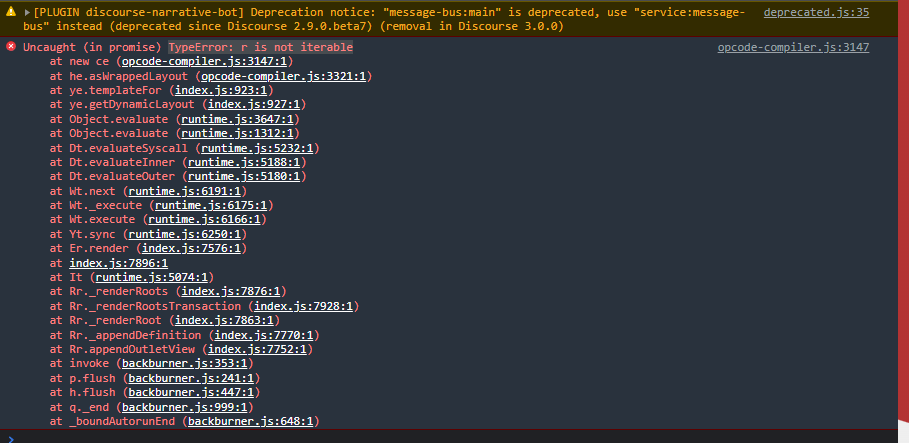

I’m getting an error but I couldn’t find the reason. Could you help me with this?
I refresh the page and it gives the error I shared below in the chrome console. What should I do?

Hm, this is in “opcode-compiler”. What plugins do you have installed?
Can you test in safe mode as well? Does it work?

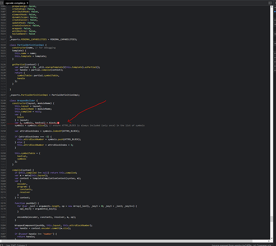

I have seen this same error locally, and I thought it was a regression but while I was trying to determine when this would have regressed (via git bisect) it magically got solved. I believe it was because there was a corrupt build cache that got reset while bisecting.
In a production environment, you can try rebuilding your site, there is a good chance that it will resolve the issue.
