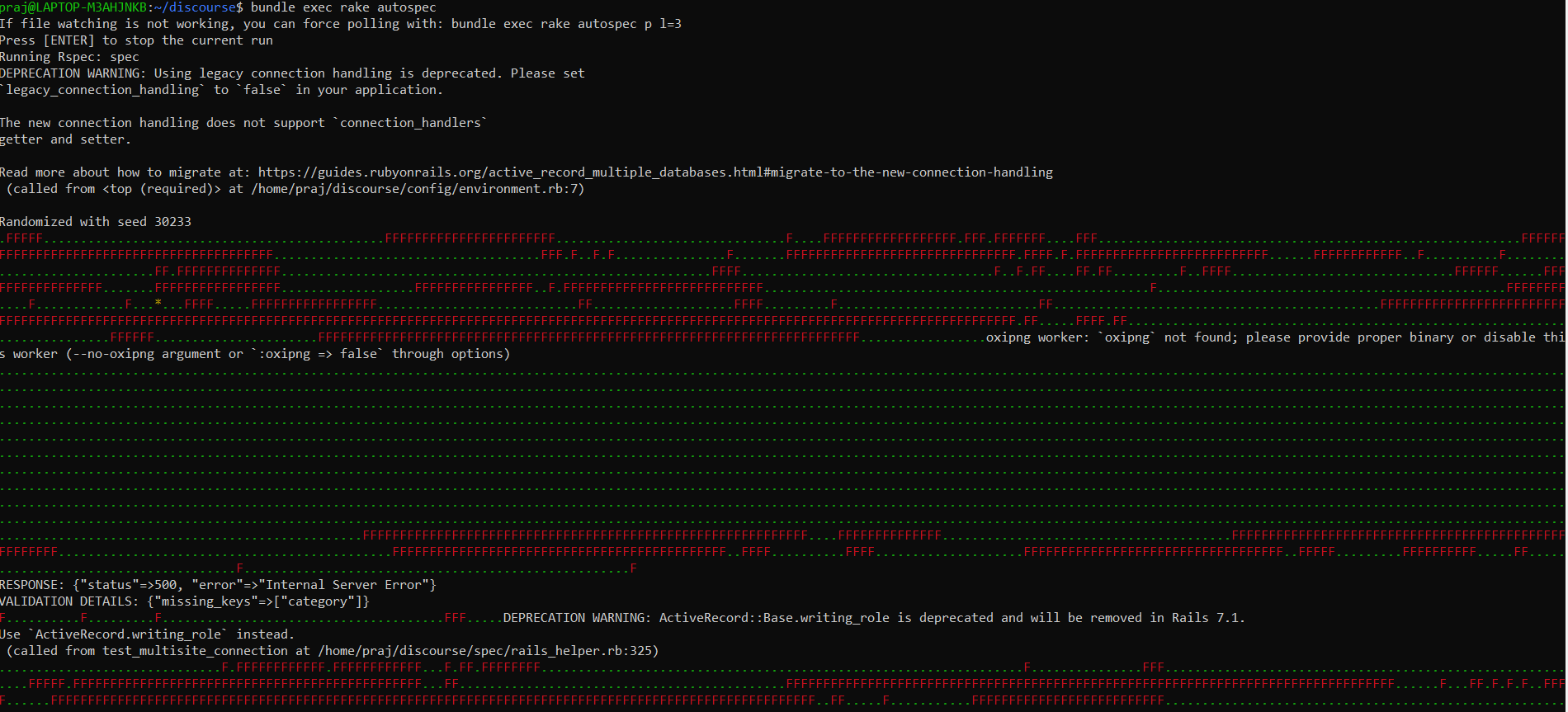

praj@LAPTOP-M3AHJNKB:~/discourse$ bundle exec rake autospec
If file watching is not working, you can force polling with: bundle exec rake autospec p l=3
Press [ENTER] to stop the current run
Running Rspec: spec
DEPRECATION WARNING: Using legacy connection handling is deprecated. Please set
`legacy_connection_handling` to `false` in your application.
The new connection handling does not support `connection_handlers`
getter and setter.
Randomized with seed 30233
.FFFFF..............................................FFFFFFFFFFFFFFFFFFFFFFF...............................F....FFFFFFFFFFFFFFFFFF.FFF.FFFFFFF....FFF.........................................................FFFFFFFFFFFFFFFFFFFFFFFFFFFFFFFFFFFFFFFFFFF....................................FFF.F..F.F...............F.......FFFFFFFFFFFFFFFFFFFFFFFFFFFFFFF.FFFF.F.FFFFFFFFFFFFFFFFFFFFFFFFFF......FFFFFFFFFFFF..F..........F.............................FF.FFFFFFFFFFFFFF..........................................................FFFF..................................F..F.FF....FF.FF.........F..FFFF..............................FFFFFF......FFFFFFFFFFFFFFFFF.......FFFFFFFFFFFFFFFFF..................FFFFFFFFFFFFFFFF..F.FFFFFFFFFFFFFFFFFFFFFFFFFFF....................................................F...............................................FFFFFFFF....F............F...*...FFFF.....FFFFFFFFFFFFFFFFF...........................FF...................FFFF.........F...........................FF............................................FFFFFFFFFFFFFFFFFFFFFFFFFFFFFFFFFFFFFFFFFFFFFFFFFFFFFFFFFFFFFFFFFFFFFFFFFFFFFFFFFFFFFFFFFFFFFFFFFFFFFFFFFFFFFFFFFFFFFFFFFFFFFFFFFFFFFFFFFFFFFFFFFFFFFFFFFFFFFFFFFF.FF.....FFFF.FF..........................................................................FFFFFF......................FFFFFFFFFFFFFFFFFFFFFFFFFFFFFFFFFFFFFFFFFFFFFFFFFFFFFFFFFFFFFFFFFFFFFFFFF.................oxipng worker: `oxipng` not found; please provide proper binary or disable this worker (--no-oxipng argument or `:oxipng => false` through options)
Tutti i test dovrebbero passare.
Avvia il server rails:
bundle exec rails server
Il seed casuale continua a essere eseguito con diversi punti e nel mezzo alcuni caratteri “F” vengono eseguiti..

        expected: 2
             got: 1
        (compared using ==)
      # ./spec/lib/middleware/request_tracker_spec.rb:61:in `block (3 levels) in <main>'
      # ./spec/rails_helper.rb:278:in `block (2 levels) in <top (required)>'
  20) Middleware::RequestTracker log_request can log Discourse user agent requests correctly
      Failure/Error: expect(ApplicationRequest.page_view_crawler.first.count).to eq(1)
        expected: 1
             got: 3
        (compared using ==)
      # ./spec/lib/middleware/request_tracker_spec.rb:114:in `block (3 levels) in <main>'
  21) Middleware::RequestTracker log_request when ignoring anonymous page views does not ignore anonymous requests for public sites
      Failure/Error: expect(ApplicationRequest.http_total.first.count).to eq(2)
        expected: 2
             got: 14
        (compared using ==)
      # ./spec/lib/middleware/request_tracker_spec.rb:159:in `block (4 levels) in <main>'
  22) Middleware::RequestTracker log_request when ignoring anonymous page views ignores anonymous requests for private sites
        expected: 2
             got: 14
        (compared using ==)
      # ./spec/lib/middleware/request_tracker_spec.rb:174:in `block (4 levels) in <main>'
  23) Middleware::RequestTracker full request can handle rogue user agents
      Failure/Error: expect(WebCrawlerRequest.where(user_agent: agent.encode('utf-8')).count).to eq(1)
        expected: 1
             got: 3
        (compared using ==)
      # ./spec/lib/middleware/request_tracker_spec.rb:35:in `block (3 levels) in <main>'
  24) ApplicationController#handle_theme selects the theme the user has selected
      Failure/Error: expect(controller.theme_id).to eq(SiteSetting.default_theme_id)
        expected: -1
             got: nil
        (compared using ==)
      # ./spec/requests/application_controller_spec.rb:454:in `block (3 levels) in <main>'
  25) ApplicationController#handle_theme does not allow non privileged user to preview themes
        expected: -1
             got: nil
        (compared using ==)
      # ./spec/requests/application_controller_spec.rb:492:in `block (3 levels) in <main>'
  26) CookedPostProcessor#post_process when processing images with title only generates overlay information using image title
      Failure/Error:
                  expect(cpp.html).to match_html <<~HTML
                    <p><div class="lightbox-wrapper"><a class="lightbox" href="//test.localhost#{upload.url}" data-download-href="//test.localhost/#{upload_path}/#{upload.sha1}" title="WAT"><img src="//test.localhost/#{upload_path}/optimized/1X/#{upload.sha1}_#{OptimizedImage::VERSION}_690x788.png" title="WAT" width="690" height="788"><div class="meta"><svg class="fa d-icon d-icon-far-image svg-icon" aria-hidden="true"><use href="#far-image"></use></svg><span class="filename">WAT</span><span class="informations">1750×2000 1.21 KB</span><svg class="fa d-icon d-icon-discourse-expand svg-icon" aria-hidden="true"><use href="#discourse-expand"></use></svg></div></a></div></p>
                  HTML
        after sanitizing for extra white space and compactness, expected:
        <p><div class="lightbox-wrapper"><a class="lightbox" href="//test.localhost/uploads/default/test_0/original/2X/a/a7f1ce9ea8991b68653b7ccce93545821a64eac8.png" data-download-href="//test.localhost/uploads/default/test_0/a7f1ce9ea8991b68653b7ccce93545821a64eac8" title="WAT"><img src="//test.localhost/uploads/default/test_0/original/1X/a7f1ce9ea8991b68653b7ccce93545821a64eac8.png" title="WAT" width="690" height="788"><div class="meta">
         to match:
        <p><div class="lightbox-wrapper"><a class="lightbox" href="//test.localhost/uploads/default/test_0/original/1X/a7f1ce9ea8991b68653b7ccce93545821a64eac8.png" data-download-href="//test.localhost/uploads/default/test_0/a7f1ce9ea8991b68653b7ccce93545821a64eac8" title="WAT"><img src="//test.localhost/uploads/default/test_0/optimized/1X/a7f1ce9ea8991b68653b7ccce93545821a64eac8_2_690x788.png" title="WAT" width="690" height="788"><div class="meta"><svg class="fa d-icon d-icon-far-image svg-icon" aria-hidden="true"><use href="#far-image"></use></svg><span class="filename">WAT</span><span class="informations">1750×2000 1.21 KB</span><svg class="fa d-icon d-icon-discourse-expand svg-icon" aria-hidden="true"><use href="#discourse-expand"></use></svg></div></a></div></p>
      # ./spec/lib/cooked_post_processor_spec.rb:712:in `block (5 levels) in <main>'
  27) CookedPostProcessor#post_process when processing images with iPhone X screenshots crops the image
      Failure/Error:
                    <p><div class="lightbox-wrapper"><a class="lightbox" href="//test.localhost#{upload.url}" data-download-href="//test.localhost/#{upload_path}/#{upload.sha1}" title="logo.png"><img src="//test.localhost/#{upload_path}/optimized/1X/#{upload.sha1}_#{OptimizedImage::VERSION}_230x500.png" width="230" height="500"><div class="meta"><svg class="fa d-icon d-icon-far-image svg-icon" aria-hidden="true"><use href="#far-image"></use></svg><span class="filename">logo.png</span><span class="informations">1125×2436 1.21 KB</span><svg class="fa d-icon d-icon-discourse-expand svg-icon" aria-hidden="true"><use href="#discourse-expand"></use></svg></div></a></div></p>
                  HTML
        <p><div class="lightbox-wrapper"><a class="lightbox" href="//test.localhost/uploads/default/test_0/original/2X/a/a4bde38a475244bf968492a174dae41c6fc586ed.png" data-download-href="//test.localhost/uploads/default/test_0/a4bde38a475244bf968492a174dae41c6fc586ed" title="logo.png"><img src="//test.localhost/uploads/default/test_0/original/1X/a4bde38a475244bf968492a174dae41c6fc586ed.png" width="230" height="500"><div class="meta">
         to match:
        <p><div class="lightbox-wrapper"><a class="lightbox" href="//test.localhost/uploads/default/test_0/original/1X/a4bde38a475244bf968492a174dae41c6fc586ed.png" data-download-href="//test.localhost/uploads/default/test_0/a4bde38a475244bf968492a174dae41c6fc586ed" title="logo.png"><img src="//test.localhost/uploads/default/test_0/optimized/1X/a4bde38a475244bf968492a174dae41c6fc586ed_2_230x500.png" width="230" height="500"><div class="meta"><svg class="fa d-icon d-icon-far-image svg-icon" aria-hidden="true"><use href="#far-image"></use></svg><span class="filename">logo.png</span><span class="informations">1125×2436 1.21 KB</span><svg class="fa d-icon d-icon-discourse-expand svg-icon" aria-hidden="true"><use href="#discourse-expand"></use></svg></div></a></div></p>
      # ./spec/lib/cooked_post_processor_spec.rb:616:in `block (5 levels) in <main>'
  28) CookedPostProcessor#post_process when processing images with alt only generates overlay information using image alt
      Failure/Error:
                    <p><div class="lightbox-wrapper"><a class="lightbox" href="//test.localhost#{upload.url}" data-download-href="//test.localhost/#{upload_path}/#{upload.sha1}" title="RED"><img src="//test.localhost/#{upload_path}/optimized/1X/#{upload.sha1}_#{OptimizedImage::VERSION}_690x788.png" alt="RED" width="690" height="788"><div class="meta"><svg class="fa d-icon d-icon-far-image svg-icon" aria-hidden="true"><use href="#far-image"></use></svg><span class="filename">RED</span><span class="informations">1750×2000 1.21 KB</span><svg class="fa d-icon d-icon-discourse-expand svg-icon" aria-hidden="true"><use href="#discourse-expand"></use></svg></div></a></div></p>
                  HTML
        <p><div class="lightbox-wrapper"><a class="lightbox" href="//test.localhost/uploads/default/test_0/original/2X/4/42792bed56e0662f221c635573264fa7826744bf.png" data-download-href="//test.localhost/uploads/default/test_0/42792bed56e0662f221c635573264fa7826744bf" title="RED"><img src="//test.localhost/uploads/default/test_0/original/1X/42792bed56e0662f221c635573264fa7826744bf.png" alt="RED" width="690" height="788"><div class="meta">
         to match:
        <p><div class="lightbox-wrapper"><a class="lightbox" href="//test.localhost/uploads/default/test_0/original/1X/42792bed56e0662f221c635573264fa7826744bf.png" data-download-href="//test.localhost/uploads/default/test_0/42792bed56e0662f221c635573264fa7826744bf" title="RED"><img src="//test.localhost/uploads/default/test_0/optimized/1X/42792bed56e0662f221c635573264fa7826744bf_2_690x788.png" alt="RED" width="690" height="788"><div class="meta"><svg class="fa d-icon d-icon-far-image svg-icon" aria-hidden="true"><use href="#far-image"></use></svg><span class="filename">RED</span><span class="informations">1750×2000 1.21 KB</span><svg class="fa d-icon d-icon-discourse-expand svg-icon" aria-hidden="true"><use href="#discourse-expand"></use></svg></div></a></div></p>
      # ./spec/lib/cooked_post_processor_spec.rb:740:in `block (5 levels) in <main>'
  29) CookedPostProcessor#post_process when processing images with large images generates overlay information
      Failure/Error:
                    <p><div class="lightbox-wrapper"><a class="lightbox" href="//test.localhost#{upload.url}" data-download-href="//test.localhost/#{upload_path}/#{upload.sha1}" title="logo.png"><img src="//test.localhost/#{upload_path}/optimized/1X/#{upload.sha1}_#{OptimizedImage::VERSION}_690x788.png" width="690" height="788"><div class="meta"><svg class="fa d-icon d-icon-far-image svg-icon" aria-hidden="true"><use href="#far-image"></use></svg><span class="filename">logo.png</span><span class="informations">1750×2000 1.21 KB</span><svg class="fa d-icon d-icon-discourse-expand svg-icon" aria-hidden="true"><use href="#discourse-expand"></use></svg></div></a></div></p>
                  HTML
        <p><div class="lightbox-wrapper"><a class="lightbox" href="//test.localhost/uploads/default/test_0/original/2X/2/226f54f14b0598565102b28645b46d185fc9e074.png" data-download-href="//test.localhost/uploads/default/test_0/226f54f14b0598565102b28645b46d185fc9e074" title="logo.png"><img src="//test.localhost/uploads/default/test_0/original/1X/226f54f14b0598565102b28645b46d185fc9e074.png" width="690" height="788"><div class="meta">
         to match:
        <p><div class="lightbox-wrapper"><a class="lightbox" href="//test.localhost/uploads/default/test_0/original/1X/226f54f14b0598565102b28645b46d185fc9e074.png" data-download-href="//test.localhost/uploads/default/test_0/226f54f14b0598565102b28645b46d185fc9e074" title="logo.png"><img src="//test.localhost/uploads/default/test_0/optimized/1X/226f54f14b0598565102b28645b46d185fc9e074_2_690x788.png" width="690" height="788"><div class="meta"><svg class="fa d-icon d-icon-far-image svg-icon" aria-hidden="true"><use href="#far-image"></use></svg><span class="filename">logo.png</span><span class="informations">1750×2000 1.21 KB</span><svg class="fa d-icon d-icon-discourse-expand svg-icon" aria-hidden="true"><use href="#discourse-expand"></use></svg></div></a></div></p>
      # ./spec/lib/cooked_post_processor_spec.rb:429:in `block (5 levels) in <main>'
  30) CookedPostProcessor#post_process when processing images with large images when using subfolders should escape the filename
      Failure/Error: stub_request(:get, "http://#{Discourse.current_hostname}/subfolder#{upload.url}").to_return(status: 200, body: File.new(Discourse.store.path_for(upload)))
      Errno::ENOENT:
        No such file or directory @ rb_sysopen - /home/praj/discourse/public/uploads/default/test_0/original/1X/02e0b630309b80d1e825a507acab66738c6806e4.png
      # ./spec/lib/cooked_post_processor_spec.rb:638:in `initialize'
      # ./spec/lib/cooked_post_processor_spec.rb:638:in `new'
      # ./spec/lib/cooked_post_processor_spec.rb:638:in `block (5 levels) in <main>'
  31) CookedPostProcessor#post_process when processing images with large images when using subfolders generates overlay information
      Errno::ENOENT:
  32) CookedPostProcessor#post_process when processing images with title and alt generates overlay information using image title and ignores alt
      Failure/Error:
                    <p><div class="lightbox-wrapper"><a class="lightbox" href="//test.localhost#{upload.url}" data-download-href="//test.localhost/#{upload_path}/#{upload.sha1}" title="WAT"><img src="//test.localhost/#{upload_path}/optimized/1X/#{upload.sha1}_#{OptimizedImage::VERSION}_690x788.png" title="WAT" alt="RED" width="690" height="788"><div class="meta"><svg class="fa d-icon d-icon-far-image svg-icon" aria-hidden="true"><use href="#far-image"></use></svg><span class="filename">WAT</span><span class="informations">1750×2000 1.21 KB</span><svg class="fa d-icon d-icon-discourse-expand svg-icon" aria-hidden="true"><use href="#discourse-expand"></use></svg></div></a></div></p>
                  HTML
        <p><div class="lightbox-wrapper"><a class="lightbox" href="//test.localhost/uploads/default/test_0/original/2X/a/a8535366575dbb938beeb6902a5033c18eb995bd.png" data-download-href="//test.localhost/uploads/default/test_0/a8535366575dbb938beeb6902a5033c18eb995bd" title="WAT"><img src="//test.localhost/uploads/default/test_0/original/1X/a8535366575dbb938beeb6902a5033c18eb995bd.png" title="WAT" alt="RED" width="690" height="788"><div class="meta">
         to match:
        <p><div class="lightbox-wrapper"><a class="lightbox" href="//test.localhost/uploads/default/test_0/original/1X/a8535366575dbb938beeb6902a5033c18eb995bd.png" data-download-href="//test.localhost/uploads/default/test_0/a8535366575dbb938beeb6902a5033c18eb995bd" title="WAT"><img src="//test.localhost/uploads/default/test_0/optimized/1X/a8535366575dbb938beeb6902a5033c18eb995bd_2_690x788.png" title="WAT" alt="RED" width="690" height="788"><div class="meta"><svg class="fa d-icon d-icon-far-image svg-icon" aria-hidden="true"><use href="#far-image"></use></svg><span class="filename">WAT</span><span class="informations">1750×2000 1.21 KB</span><svg class="fa d-icon d-icon-discourse-expand svg-icon" aria-hidden="true"><use href="#discourse-expand"></use></svg></div></a></div></p>
      # ./spec/lib/cooked_post_processor_spec.rb:684:in `block (5 levels) in <main>'
  33) Wizard::Builder styling with colors when the default theme has been overridden by a theme without a color scheme should set the right default values
      Failure/Error: expect(colors_field.required).to eq(false)
        expected: false
             got: true
        (compared using ==)
        Diff:
        @@ -1 +1 @@
        -false
        +true
      # ./spec/lib/wizard/wizard_builder_spec.rb:100:in `block (5 levels) in <main>'
  34) Wizard::Builder styling with colors when the default theme has not been override should set the right default values
      Failure/Error: SiteSetting.find_by(name: "default_theme_id").destroy!
      NoMethodError:
        undefined method `destroy!' for nil:NilClass
      # ./spec/lib/wizard/wizard_builder_spec.rb:71:in `block (5 levels) in <main>'
  35) Wizard::Builder styling with colors when the default theme has been override and the color scheme doesn't have a base scheme fallbacks to the color scheme name
        expected: false
             got: true
        (compared using ==)
        Diff:
        @@ -1 +1 @@
        -false
        +true
      # ./spec/lib/wizard/wizard_builder_spec.rb:89:in `block (5 levels) in <main>'
  36) Wizard::Builder styling with colors when the default theme has been overridden by a theme with a color scheme should set the right default values
        expected: false
             got: true
        (compared using ==)
        Diff:
        @@ -1 +1 @@
        -false
        +true
      # ./spec/lib/wizard/wizard_builder_spec.rb:112:in `block (5 levels) in <main>'
Terminato in 33 minuti 32 secondi (i file hanno richiesto 13.53 secondi per essere caricati)
16862 esempi, 36 falliti, 7 in attesa
Esempi falliti:
rspec ./spec/helpers/application_helper_spec.rb:189 # ApplicationHelper application_logo_dark_url quando il tema scuro è presente quando il logo scuro è presente dovrebbe restituire l'URL corretto
rspec ./spec/lib/backup_restore/database_restorer_spec.rb:63 # BackupRestore::DatabaseRestorer#restore con psql reale ripristina da PostgreSQL 10
rspec ./spec/models/optimized_image_spec.rb:8 # OptimizedImage.crop dovrebbe produrre immagini ritagliate (richiede ImageMagick 7)
rspec ./spec/jobs/clean_up_crawler_stats_spec.rb:17 # Jobs::CleanUpCrawlerStats mantiene solo i record principali del giorno precedente
rspec ./spec/models/report_spec.rb[1:17:1:1] # Report page_view_logged_in report di richieste senza record page_view_logged_in restituisce un report vuoto
rspec ./spec/models/report_spec.rb[1:17:2:1] # Report page_view_logged_in report di richieste con page_view_logged_in restituisce un report con dati
rspec ./spec/models/report_spec.rb:1194 # Report consolidated_page_views senza dati funziona
rspec ./spec/models/report_spec.rb[1:12:1:1] # Report http_background report di richieste senza record http_background restituisce un report vuoto
rspec ./spec/models/report_spec.rb[1:12:2:1] # Report http_background report di richieste con http_background restituisce un report con dati
rspec ./spec/models/report_spec.rb[1:10:1:1] # Report http_total report di richieste senza record http_total restituisce un report vuoto
rspec ./spec/models/report_spec.rb[1:10:2:1] # Report http_total report di richieste con http_total restituisce un report con dati
rspec ./spec/models/report_spec.rb[1:18:1:1] # Report page_view_anon report di richieste senza record page_view_anon restituisce un report vuoto
rspec ./spec/models/report_spec.rb[1:18:2:1] # Report page_view_anon report di richieste con page_view_anon restituisce un report con dati
rspec ./spec/models/report_spec.rb[1:11:2:1] # Report http_2xx report di richieste con http_2xx restituisce un report con dati
rspec ./spec/models/report_spec.rb[1:11:1:1] # Report http_2xx report di richieste senza record http_2xx restituisce un report vuoto
rspec ./spec/models/report_spec.rb[1:16:1:1] # Report page_view_crawler report di richieste senza record page_view_crawler restituisce un report vuoto
rspec ./spec/models/report_spec.rb[1:16:2:1] # Report page_view_crawler report di richieste con page_view_crawler restituisce un report con dati
rspec ./spec/lib/middleware/request_tracker_spec.rb:64 # Middleware::RequestTracker log_request può registrare le richieste correttamente
rspec ./spec/lib/middleware/request_tracker_spec.rb:53 # Middleware::RequestTracker log_request può escludere/includere in base a un'intestazione personalizzata
rspec ./spec/lib/middleware/request_tracker_spec.rb:103 # Middleware::RequestTracker log_request può registrare correttamente le richieste dell'user agent di Discourse
rspec ./spec/lib/middleware/request_tracker_spec.rb:151 # Middleware::RequestTracker log_request quando ignora le visualizzazioni di pagine anonime non ignora le richieste anonime per i siti pubblici
rspec ./spec/lib/middleware/request_tracker_spec.rb:166 # Middleware::RequestTracker log_request quando ignora le visualizzazioni di pagine anonime ignora le richieste anonime per i siti privati
rspec ./spec/lib/middleware/request_tracker_spec.rb:27 # Middleware::RequestTracker richiesta completa può gestire user agent errati
rspec ./spec/requests/application_controller_spec.rb:443 # ApplicationController#handle_theme seleziona il tema scelto dall'utente
rspec ./spec/requests/application_controller_spec.rb:489 # ApplicationController#handle_theme non consente a un utente non privilegiato di visualizzare in anteprima i temi
rspec ./spec/lib/cooked_post_processor_spec.rb:709 # CookedPostProcessor#post_process quando elabora immagini con solo titolo genera informazioni di sovrapposizione usando il titolo dell'immagine
rspec ./spec/lib/cooked_post_processor_spec.rb:613 # CookedPostProcessor#post_process quando elabora immagini con screenshot di iPhone X ritaglia l'immagine
rspec ./spec/lib/cooked_post_processor_spec.rb:737 # CookedPostProcessor#post_process quando elabora immagini con solo testo alternativo genera informazioni di sovrapposizione usando il testo alternativo dell'immagine
rspec ./spec/lib/cooked_post_processor_spec.rb:426 # CookedPostProcessor#post_process quando elabora immagini con immagini di grandi dimensioni genera informazioni di sovrapposizione
rspec ./spec/lib/cooked_post_processor_spec.rb:654 # CookedPostProcessor#post_process quando elabora immagini con immagini di grandi dimensioni quando usa sottocartelle dovrebbe escapare il nome del file
rspec ./spec/lib/cooked_post_processor_spec.rb:644 # CookedPostProcessor#post_process quando elabora immagini con immagini di grandi dimensioni quando usa sottocartelle genera informazioni di sovrapposizione
rspec ./spec/lib/cooked_post_processor_spec.rb:681 # CookedPostProcessor#post_process quando elabora immagini con titolo e testo alternativo genera informazioni di sovrapposizione usando il titolo dell'immagine e ignora il testo alternativo
rspec ./spec/lib/wizard/wizard_builder_spec.rb:99 # Wizard::Builder stile con colori quando il tema predefinito è stato sovrascritto da un tema senza schema di colori dovrebbe impostare i valori predefiniti corretti
rspec ./spec/lib/wizard/wizard_builder_spec.rb:74 # Wizard::Builder stile con colori quando il tema predefinito non è stato sovrascritto dovrebbe impostare i valori predefiniti corretti
rspec ./spec/lib/wizard/wizard_builder_spec.rb:88 # Wizard::Builder stile con colori quando il tema predefinito è stato sovrascritto e lo schema di colori non ha uno schema di base di fallback torna al nome dello schema di colori
rspec ./spec/lib/wizard/wizard_builder_spec.rb:111 # Wizard::Builder stile con colori quando il tema predefinito è stato sovrascritto da un tema con schema di colori dovrebbe impostare i valori predefiniti corretti
Randomizzato con seed 55699
I seguenti test hanno fallito:
./spec/models/report_spec.rb:206
./spec/models/report_spec.rb:224

Randomizzato con seed 22377
...................................................................................................................................................................................................................................................................................................................................................................................................................................................................................................................................................................................................................................................................................................................................................................................................................................................................................................................................................................................................................................................................................AVVISO DEPRECAZIONE: ActiveRecord::Base.writing_role è deprecato e verrà rimosso in Rails 7.1.
Usa `ActiveRecord.writing_role` invece.
 (chiamato da block (2 levels) in <top (required)> in /home/praj/discourse/spec/rails_helper.rb:304)
..........................................................................................................................................................................................................................................................................................................................................................................................................................FFFF.......................................................................................................................................................................................................................................................................................................................................................................................................F....................................................................................................................................................................................................................................worker oxipng: `oxipng` non trovato; fornisci il binario appropriato o disabilita questo worker (argomento --no-oxipng o `:oxipng => false` tramite opzioni)
Questo suggerisce che il server rails non è in esecuzione. Il che è strano perché apparentemente hai eseguito il comando. Devi lasciare il server rails in esecuzione in un’altra sessione del terminale prima di avviare ember. Non è sufficiente eseguire solo il server ember del frontend.
Puoi provare ad eseguire bin/ember-cli -u dalla cartella discourse?

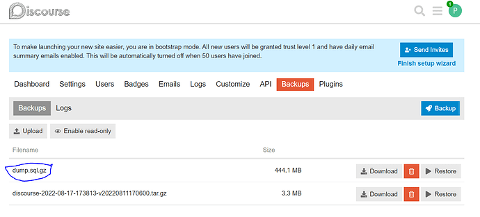

Grazie @merefield e @Falco. La configurazione locale è completata. Ora riesco ad accedere al mio sito http://localhost:4200/.
Una domanda veloce,
Ho un file di dump (sql.zip) del sito esistente. Voglio importare questo db nel mio locale. Potete suggerirmi come migrare nel mio locale?
Grazie,
Pradeepraj RS
Qualcuno può suggerirmi come posso importare il mio database esistente nella mia configurazione locale?
Grazie,
Pradeepraj RS
Caricalo su quella pagina dall’ultimo screenshot e fai clic sul pulsante “> Ripristina” nella riga in cui appare.
