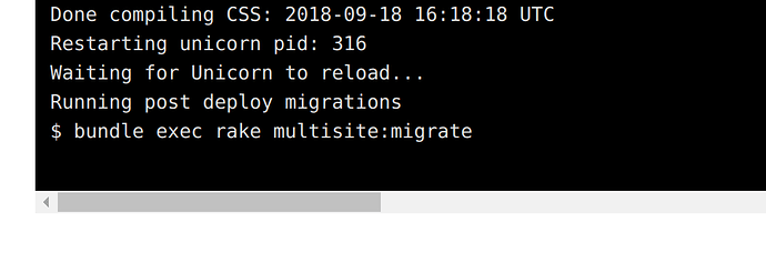

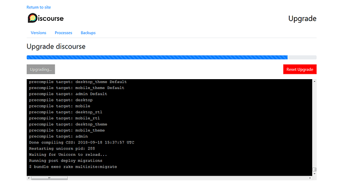

Hey Roger, can you share any details on where it is stuck at?
For example:
or
Also it would help if you could share your CPU/Disk size.
