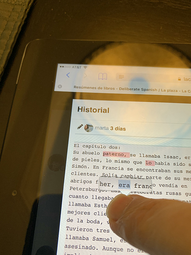

I’m getting a 422 error when uploading this HEIC image in my forum:
I just tried it here and the conversion happened correctly:
