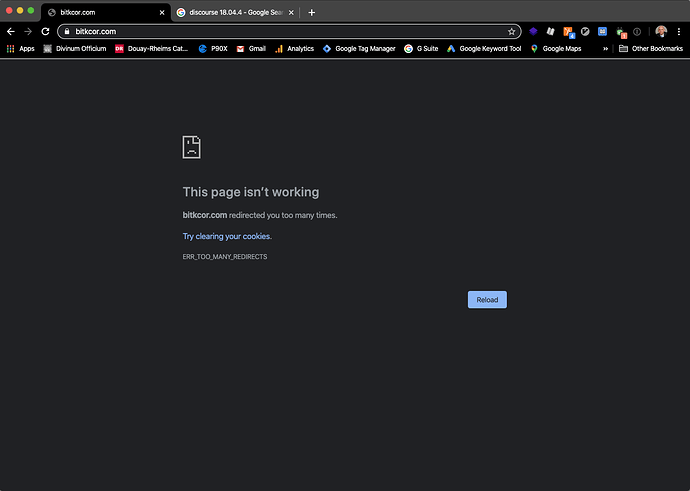

Removed the nginx welcome page, but now nothing loads — https://bitkcor.com/
Still staring at a blank page. Do I need to restart something now? Any suggestions?

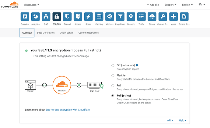

Actually. Just set the SSL back to strict in Cloudflare and it brought it all back.
sudo systemctl stop nginx was the answer.
Thank you @riking!
