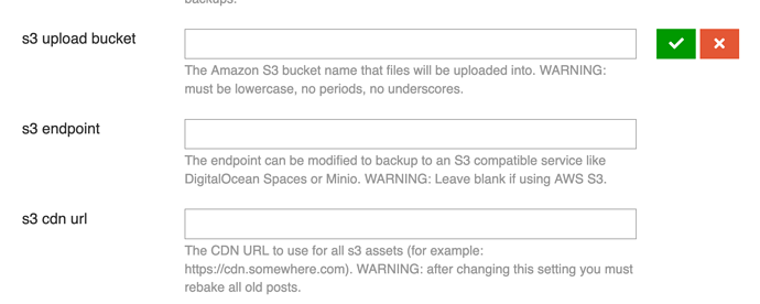

So I have an Amazon S3 bucket set up to store my forum assets, and I put it on a custom domain and set up CloudFlare CDN to cache the content.
My custom domain is called something like http://forum-storage.com, which points to https://forum-storage.com.s3-us-east-1.amazonaws.com. The S3 bucket itself is named forum-storage.com.
This is all working correctly. If I add an image to the main folder of the bucket, I can retrieve it on my custom url, i.e. http://forum-storage.com/test.jpg returns the image, with the CloudFlare headers.
Three easy questions…
#1
Now I need to tell Discourse to use this new URL as my S3 bucket. What do I put in these 3 fields?

:rotating_light: STOP NOW :rotating_light:
Create a new bucket that does not have a dot in its name. You will encounter endless suffering if you continue, due to how SSL wildcard certificates work.
Ref: Discourse does not allow dot «.» symbol in bucket name while Amazon S3 allows it
Ref: https://stackoverflow.com/questions/62568657/ssl-certificate-issue-with-bucket-name-containing-dots-while-trying-to-use

Discourse will generate direct bucket URLs and use those for internal operations, such as “uploading a file”. It still matters.
@riking All Discourse seems to require is a bucket name, correct? Upload and management can be done on AWS URL’s with their certificates, if HTTPS is even required. So far is there any reason we are talking about security certs?
OP then can separately look at what he needs to do to allow his CDN or caching solution to fetch the images from S3. Secure or not, doesn’t matter unless OP or the CDN have requirements, right? Does Discourse care about his setup between S3 and CDN?
Finally, OP needs to make sure the images are served from the CDN with a valid cert. Does this have anything to do with Discourse other than OP supplying the base URL for the images will ultimately reside? Once his CDN or cache fetches the images from S3, then AWS, buckets, blah blah blah are out of the picture completely.
I get that there are issues about a dot in S3 bucket names if you intend to serve your images from there but the OP does NOT. So it just comes down to OP picking any bucket name that Discourse will accept, as long as it doesn’t interfere with whatever setup he has with CDN.
Even though it’s possible to avoid the bucket-in-domain URLs, it’s not actually avoided due to the way the aws s3 sdk is used and the difficulty? of configuring it.
Again, these operations bypass the CDN, the only way to fix them is in the Discourse source. They can be fixed, but currently aren’t. Many of the issues also don’t happen on the critical path, and only show up later. So until this changes, do not use bucket names with dots in them.
So just to boil this down to drop dead simple… OP’s question was what to fill in to three settings to configure:
(1) BUCKET NAME – so it is being said that dots are not… recommended? not allowed? I suspect this may not be a problem for OP. (He just needs to separately figure out a way for his CDN to get images to cache and serve.) So we’re all on the same page here, right?
(2) S3 ENDPOINT – leave blank, nothing needed if he is using AWS, otherwise he can fill in for another provider?
(3) S3 CDN URL – is this simply the base URL that Discourse will prepend to the image path? If so, then that is simple and straightforward and the OP can configure his CDN and supply that base URL here.

So OP can simply…
(1) pick an S3 and CDN compatible storage solution and configure endpoint and bucket name in Discourse settings.
(2) Configure CDN to fetch images from S3. Secure or insecure. I don’t think OP cares as long as CDN serves to user via HTTPS.
Someone please correct me if I am missing something here. I think the end user browser cert + dot in bucket name problem is ONLY an issue if you are going to serve the images FROM the bucket. Irrelevant to serving from CDN.
p.s. this topic, that @pfaffman helpfully linked to above, points out that Digital Oceans’ S3 product (“Spaces”) has an “awfully broken” CDN.
And I see that for other S3 providers, there are various settings that have to be tweaked.
What this is telling me:
  • Settings will vary from provider to provider, even if they all claim to all follow the “S3” protocol
