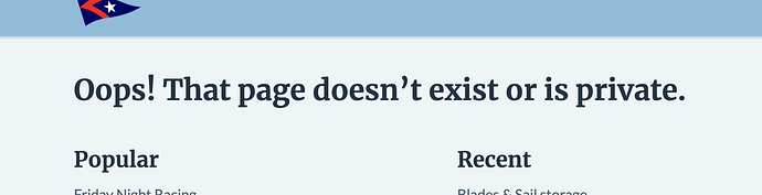

Then when I accept the invitation I get this page:
I thought this would auto subscribe them to the topic but the Notification setting for that topic is Normal. I’d like to have invited users for this topic to be set to Watching automatically.
