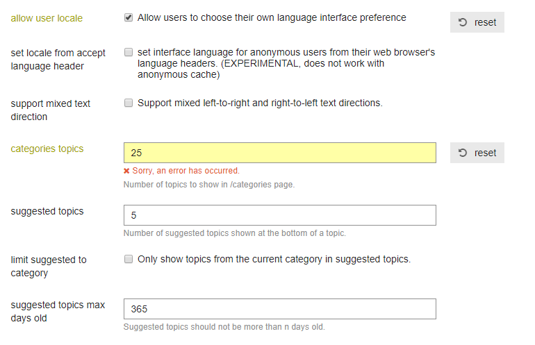

When updating a site setting, ERROR: zero-length delimited identifier
In the admin I am not able to change any fields which have turned to orange/yellow -so in other words I can only save things once (those not yet updated) - any ideas what the problem could be?
