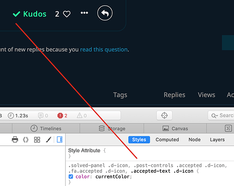

Sorry to bring this up again, but, do you know why the icon isn’t changing in the post controls?
This is the code I’m using:
Are you trying to change it specifically for that icon location and state? If you are still trying to change the icon globally the code you originally posted is still correct:

That checkmark icon next to “Kudos” is not the default, so might you have conflicting code somewhere?

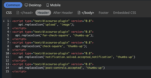

Specifically in that area, because as Kris aforementioned, sometimes the code has to be very specific. This is all the code I’ve added for changing icons:
As Kris mentioned, only some icons need special treatment. Notifications are one of those, so that’s why you needed to use notification.solved.accepted_notification. In the case of the solved icon in the post controls, it’s using the generic icon name, so you will only be able to change it globally when using the replaceIcon method.
