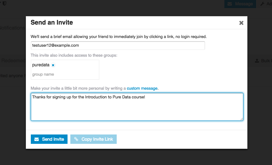

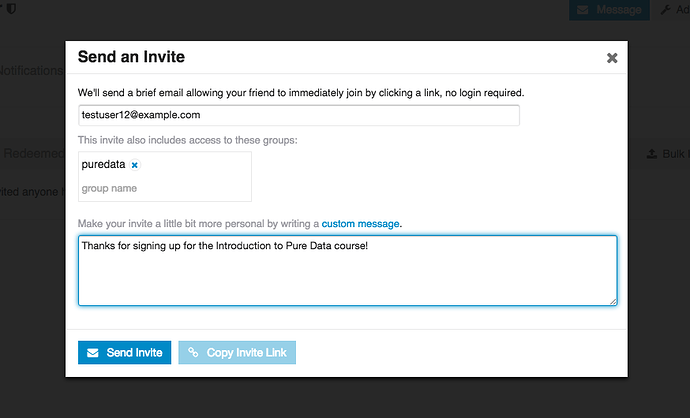

Yes, I think that using the current setup, the easiest approach would be to not enable Single Sign On (SSO) between your WordPress site and the forum. This means that the forum and the website would manage users separately. When someone signs up for a course you would send them an invitation from the forum to join the associated discussion group. This groups content on the forum could be protected using the group/category setup. The links to that groups discussions on the WordPress site would also be protected by your membership plugin.
