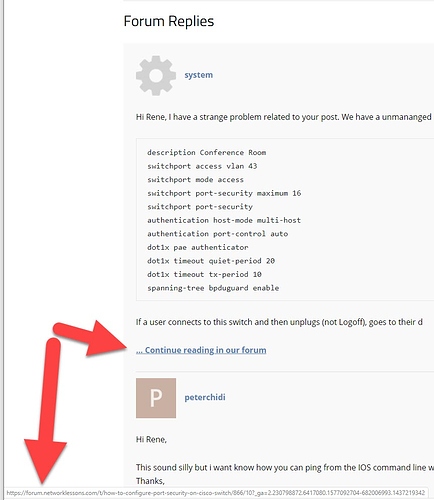

The comment links below a post sometimes show the wrong URL. For example, here’s a post:
Linked to the correct forum topic:
But showing the wrong URLs under the post:
This is the wrong topic it links to:

It is a strange issue, because the correct Discourse topic is being displayed in the Discourse metabox on your edit page. This means that the value of the discourse_permalink post metadata is correctly set.
