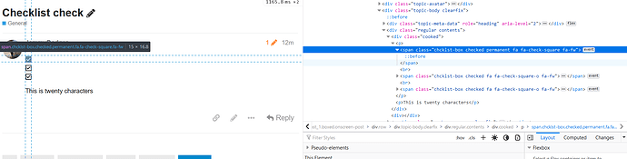

I was wondering if you had one box checked with a capital X, would all others check in the same style? It seems not, and in testing that theory, I discovered…
…the checked box with fill does not uncheck (outside of removing the X from within the editor pane). Is that intentional? What would be the use case for this variation? The odd thing is that the cursor still changes to a hand when you hover over the check box…
That’s interesting. I wonder if that’s so you can ‘lock in’ an answer? The cursor changing to a hand would be misleading in that case though.
Checking out the class and a bit of the code, it seems the [X] ones get a permanent added to them:
So I think it may be right that they don’t toggle, and it’s the ‘hovering hand’ that’s the oddity.
