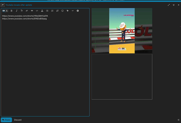

It looks like some shorts work on my site, but not all. For example, @nat’s ‘The Twins’ short gets embedded properly, but @Shauny’s does not.
And, not sure if this is relevant, but another difference I noticed between them is that Natalie’s shows a picture in the WYSIWYG preview and Shaun’s does not:
That seems to be consistent for other shorts that do and don’t embed properly on my site.
Shaun, can you replicate?
More accurately, that’s actually the composer preview (you’re in Markdown mode, not WYSIWYG).
