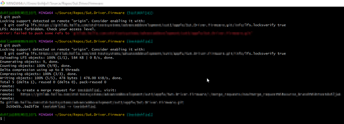

On a serious note, I have curiosity about how it would perform on an image like this:
Tesseract gets the following:
MINGW64 ~/Source/Repos/Sut. Driver. Firmware
$ git push
Locking support detected on remote ā€œoriginā€. Consider enabling it with:
$ git config Ifs ā€˜1fs.locksverify true
LFS: Access forbidden. Check your access level.
error: failed to push some refs to
$ git push
$ git config Ifs. /\fs.locksverify true
Uploading LFS objects: 100% (1/1), 584 KB | 0 B/s, done.
Enumerating objects: 9, done.
Counting objects: 100% (9/9), done.
Delta compression using up to 8 threads
Compressing objects: 100% (3/3), done.
Writing objects: 100% (5/5), 478 bytes | 478.00 KiB/s, done.
Total 5 (delta 1), reused 0 (delta 0), pack-reused 0 Ā»
remote:
remote: To create a merge request for visit:
remote: 1
remote:
To
2c50e5b. . ba25f3e
L MINGN64 ~/Source/Repos /Sut. Driver. Firmware
(Ok Iā€™m surprised at how reasonable this result is. Tesseract often changes line order and glitches letters with these types of examples.)
Sam would it be possible for you to throw that image in to claude and post the result?
Feel free to try here, Claude creative persona here has vision support, just enabled it
https://meta.discourse.org/t/parsing-complex-json-data-in-tris20-code/301329
This is either a skill issue on my side, or Claude is having little trouble :sweat_smile:
Skill issue :sweat_smile: I was using the Forum Helper rather than the Creative personality.
Claude Creative gives us this:
MINGW64 ~/Source/Repos/Sut.Driver.Firmware (kingfisher)
$ git push
$ git config lfs.http://tfs.locksverify true
error: failed to push some refs to ā€˜http://tfs.lockeed/tfs/HnC/TEC/SUT/Driver%20Firmware/_git/Sut.Driver.Firmwareā€™
$ git push
$ git config lfs.http://tfs.locked/tfs.locksverify true
remote: To create a merge request for kingfisher, visit:
remote: http://tfs.locked/tfs/HRC/TEC/SUT/_git/Sut.Driver.Firmware/pullrequest/new?sourceRef=kingfisher&targetRef=develop
remote:
To http://tfs.locked/tfs/HRC/TEC/SUT/_git/Sut.Driver.Firmware
2c50e5bā€¦ba25f3e kingfisher - kingfisher
Interesting result. I feel like the two are roughly on a par with each other in this example but with different faults. Claude has halucinated the URL here, making a contextual guess that we are doing a pull request based on the git issue.
Tesseract doesnā€™t halicunate, and in this case seems to be more correct. The only thing that stands out is 1fs on line 4, and \fs on line 10 instead of lfs.
Claude also makes a similar error throughout, using tfs instead of lfs. Itā€™s surprising because the extrapolation of URL based on context shows it understood the context, but then instead of lfs which is prominent in this problem domain, it created something completely new: tfs
