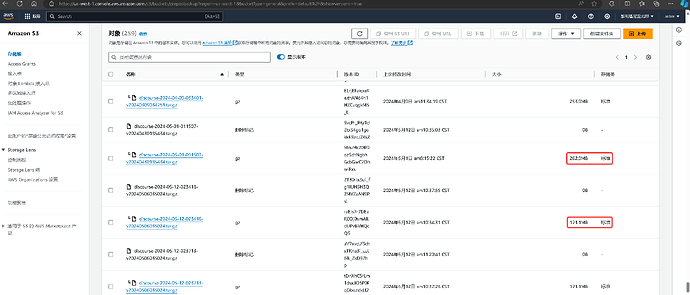

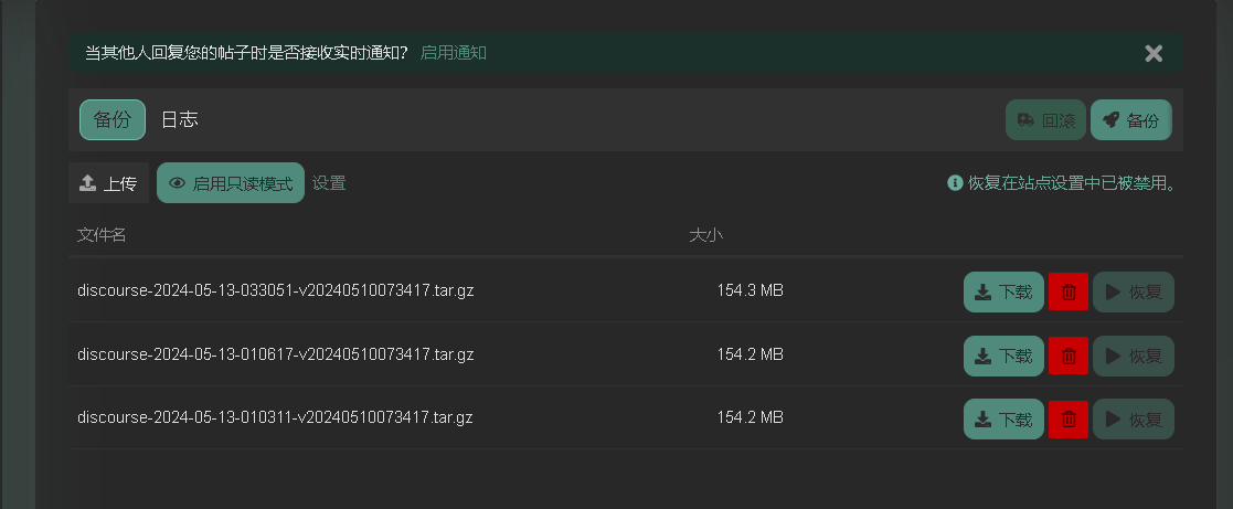

3.3.0.beta2-dev fc76622b56 Less backup data exists and cannot be restored normally
备份数据突然变少,变少的数据备份恢复异常,网站无法正常交互,还好亚马逊s3存储桶可以找到历史数据,不然损失不可估量

做了升级,使用了主题,给主题加了自定义插件(自定义css),用户可选调色关闭,使用的是data.yml、web_only.yml,使用262Mbyte恢复数据后,目前备份后也只有154Mbyte,这个备份数据估计仍然已经出问题了

My guess is that they moved assets to s3 and so the local uploads aren’t included. This is consistent with them saying that they were able to restore stuff from s3. Or maybe they deleted some posts that had uploads so those uploads weren’t included in subsequent backups.
Also, it sounded a bit like they did a restore and didn’t wait for it to finish completely.

I now understand that the problem was a big upgrade of the database that caused backup problems
