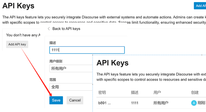

I Know, For security reasons it is displayed when you create it, then mostly hidden.
When I created it before, it would be displayed once and then hidden
Now, when it is created, it is hidden and not displayed
GIF 2025-1-9 15-42-54

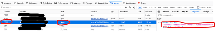

FWIW the HTTP response does contain the API key so if you “inspect” in your browsers devtools, you can get the key.
I am also experiencing this issue.
That helped, thanks!
