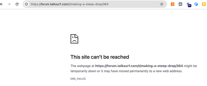

I’m going to retire https://forum.talksurf.com/.
Yes, I’m going to archive a backup.
But what if I just want some browseable HTML files?
Should I just run ArchiveDiscourse/archive-discourse.py at master · kitsandkats/ArchiveDiscourse · GitHub ?
Or is there something better?
Thanks in advance!

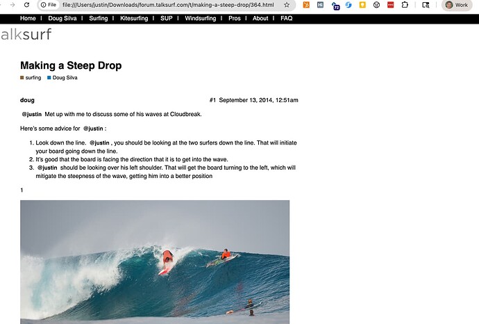

This worked. I had to make a slight code update.
https://github.com/kitsandkats/ArchiveDiscourse/pull/4

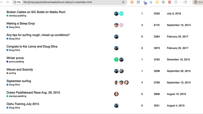

Jay kindly sent me the dump, and I compared it to mine.
His technique works better in the sense that it saves the images.
However, his internal links don’t point to the articles, but rather to the decommissioned site. However, the articles can be found with images.

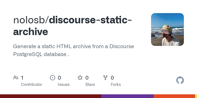

Just let Claude have a run at it, sharing here for reference and keeping this feature in the loop:
https://github.com/nolosb/discourse-static-archive
Its a basic setup so far: topics, categories, tags and users. Search also works. Uploaded an archive of a local demo instance to a github page:
