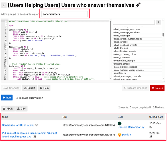

I thought that since all the users in group squad were also in group company, and group company has explicit access to the report that that would work.
But groups don’t get expanded into users (and there’s no option in the UI to turn that on)

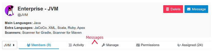

On my group I see a Messages tab.
Even as a global admin, I don’t see that on the JVM group:
So I added myself to the group, thinking maybe that was why I didn’t see it.
Still no messages tab.
Then I checked the group’s ‘interaction’ settings, and yup, messaging was set to Nobody
So I updated that to ‘Group members, moderators and admins’
But the Messages tab still doesn’t appear for the group, no matter how many times I refresh the page.
The Community Managers messaging is set to Everybody, but I don’t want to do that for this group.
I had a look into this and the interaction setting you selected should be fine, it doesn’t need to be “Everyone” to get the messages tab to show.
There are some additional steps I found that determine if the Messages tab is visible though:
  1. User must be signed in as either a group member or an admin
  2. User must be a member of a PM enabled group (ie. a member of any groups in SiteSetting.personal_message_enabled_groups) - the specific group in question doesn’t have to be in this site setting of group ids, but I think that would be a way to ensure all group members can see the messages tab.
  3. The group has received at least one messages before
In the case you are experiencing I suspect either 2 or 3 is the issue.

In the interim, I’ve realized that to send a report to a group, that individual, specific group has to have explicit permissions to the report, rather than each group recipient having permissions (via another, underlying group). Resolving the group to its users early in the process should keep me from having to add 20 (literally!) groups to every report!

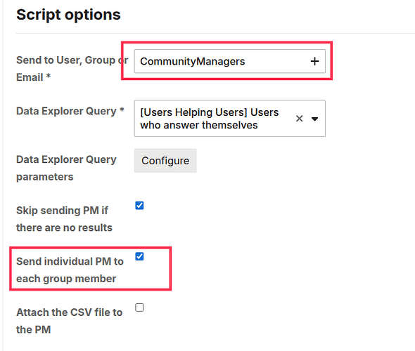

An update for this is now merged here:
https://github.com/discourse/discourse-data-explorer/pull/369
There is now a checkbox in the automation script to send individual PMs to group members. When checked, each group will have the users extracted and message individually.
Hopefully this makes the script work better for your needs.
If adding a group to the Send to User, Group or Email field then that group would need to have access to the data explorer report. The ideal scenario would be to have a larger group (maybe a reporting group) that contains all the members that you want to notify.

Hi,
This doesn’t appear to be working. As soon as I got your update, I updated the automations to use the option
And as a test, I edited two reports that are automated to run every 30min to only be shared to the larger SonarSourcers group (i.e. Employees). When I run it manually, I get results:
But even though the automation is running, the send to CommunityManagers (EmployeeSubgroup) isn’t happening. I’m not getting PMs.
