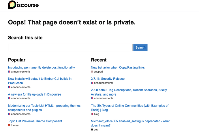

The current design prioritizes popular topics, which by their nature tend to be general. Someone hitting a 404 is likely to instead be looking for something specific. Short of magically guessing what that was, it seems like prominently providing a search box would be ideal. I know it’s there at the bottom, but… that’s kind of hard to find.) Is there an easy way to rearrange this?
And while we’re at it, something that stretches across the page rather than the current tiny box at the bottom.
It might also be nice to pre-fill the search with something constructed from the provided not-found URL. But I haven’t thought through the full implications of that.
Something like this?
I think it should be possible by hiding the page-not-found-search component at the bottom with a display: none and then inserting the code for the search box at the top using plugin outlets: Using Plugin Outlet Connectors from a Theme or Plugin
You could also add some CSS to modify the textarea width. Note I haven’t really tested any of this, I just tried it directly in the browser console.
This is the code for the search box:

Very much like that, yes, thanks! I’ll try it out later today.

And it looks great! Discourse team, any reason this isn’t the default?
By looking at olds commit, the position of the search bar seems to be something that just happened? Inherited from where the google search used to be, which was added with the initial release of Discourse.
I agree it looks better at the top.
