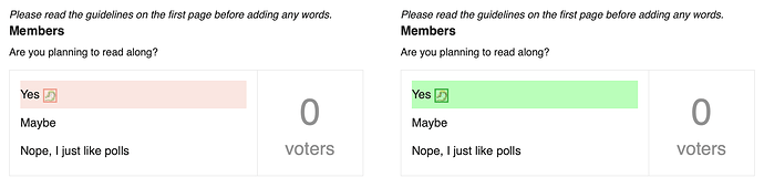

I do see a strange diff in the most recent revision history:
It gives the impression there was a change, yet when I look at the raw diff, I see no changes.
The only thing I can think of is there is some weird edge case that can happen when an emoji is used with a poll, but so far I’m not able to prove that out.

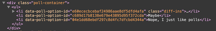

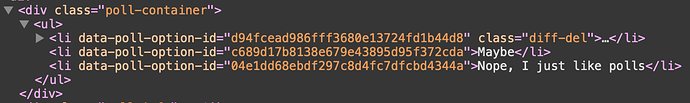

You’re on to something! If you inspect the HTML of the diff there is a change in the data-poll-option-id of the first option:
That’s all generated behind the scenes, so maybe there is, or was a bug somewhere that caused this to change.
I tried manually changing the data-poll-option-id (stored as digest in PollOption records) and can repro the issue (I’m no longer able to save an edit). If I change it back to its previous value, I can edit normally.

Ok, I have a follow-up on this. I checked with engineering and they narrowed it down to the emoji used in the poll. Its image source ended up changing in the cooked post value which put things into a bit of an odd state. The emoji source shouldn’t be changing very often, if at all, so I think it’s very unlikely this will be an ongoing problem. Unfortunately, given the rarity and the amount of effort it would take to fix existing occurrences, I’m afraid that post will need to be recreated or left as is.
