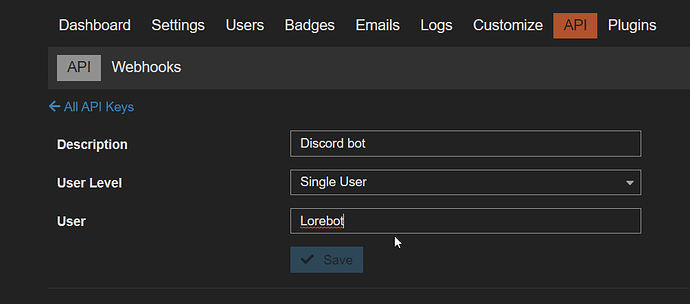

Can each user only have 1 API key? If this isn’t a bug, there definitely needs to be some guiding instructions here:
When I type this, I cannot click “Save” – why?
How about a tooltip or an error tip below that tells me why this button is disabled?
I found out later that normal usernames have suggestions that popup – existing accounts that have an API key don’t show up at all, making a truly confusing experience. When I first typed the user’s name, nothing showed up at all and had no suggestions like “user not found” or “user already has an api key (max 1)” or something.
It feels strange that I can’t assign more than 1 API key for different things, though - I thought that was the main point of API keys to keep scope very particular - feels more like a bug.

Estoy experimentando un problema similar en el que no puedo hacer clic en Guardar; aparece deshabilitado. No estoy seguro si están relacionados. Estoy creando la primera clave de API de usuario.
El botón “Guardar” estará deshabilitado hasta que rellenes el campo “Descripción”. Intenta rellenar ese campo y comprueba si entonces puedes guardar la clave API.
¡Gracias! Funcionó…
