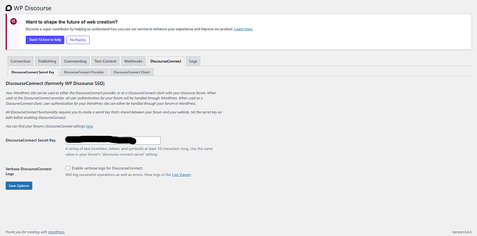

Setting a Secret Key
Whether you’re setting up WP Discourse as the DiscourseConnect Provider or Client, you need to set a secret key. Go to the “DiscourseConnect Secret Key” tab and enter a string of text (numbers, letters, and symbols are all allowed), at least 10 characters long. Use the same rules for creating this as you would to create a strong password. Make sure you save it when you’re done.
Then, open your Discourse Site Settings (in the Admin panel), and search for “discourse connect”. One of the settings near the top will be discourse connect secret. Paste the secret key you set in WP Discourse in there and click the green tick.

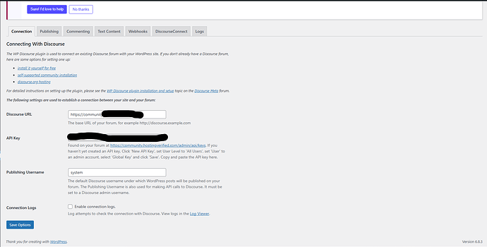

Make sure you’re WP Discourse is connected to your Discourse and your secret key is set ( :point_up: ) before following these instructions

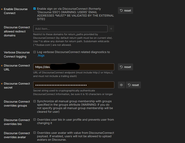

Next, go to your Discourse Site Settings and enter “discourse connect” into the search box to see all your Discourse DiscourseConnect settings. First, set the discourse connect url to the URL of our Wordpress. The final step is to select enable discourse connect. Make sure you’re ready to go before you select this as once you do, your users will only be able to log in to Discourse using Wordpress.
Once you’ve enabled discourse connect in Discourse, to make sure that it is setup correctly open an incognito window in your browser. Keep your normal (non-incognito) browser window logged in to an admin account (just in case something goes wrong and you need to change the settings back). In the incognito window you’ll notice that the Discourse ‘Sign Up’ button no longer appears. Click on the ‘Log In’ button. You should see a Wordpress login screen. Enter your Wordpress credentials to log in. You should then be redirected back to Discourse and be logged in.
If something goes wrong, or you notice something is not quite right, go back to your normal browser window and disable enable discourse connect to let your users log into Discourse normally. If you’re no longer logged in to your admin account in your normal browser window for some reason, check out the “Disable DiscourseConnect Through the Discourse Console” section in Troubleshooting below to regain access to your Discourse.

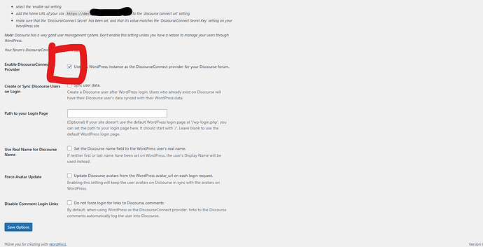

To enable your site to function as an DiscourseConnect Client for Discourse, click on the DiscourseConnect Client tab. On that page, select the Enable DiscourseConnect Client and Add Login Link options.
Now go to your Discourse Admin / Settings page and search for ‘discourse connect’ to see all your DiscourseConnect options.
  • select the ‘enable discourse connect provider’ setting
  • copy your DiscourseConnect Secret Key from WordPress to the ‘secret’ field of the Discourse ‘discourse connect provider secrets’ setting. In that setting’s ‘domain’ field enter your WordPress site’s domain. Then click the green checkmark to save your settings.
When complete, the ‘discourse connect provider secrets’ setting on Discourse should look like this (with the domain set to your WordPress domain):
Discourse should now be functioning as a DiscourseConnect provider for your WordPress site.
Open your Wordpress site in an incognito window in your browser. When you now go to your login page, you should see a ‘Log in with Discourse’ link underneath the login form. Click it and you’ll be taken to the Discourse login form. Login there, and you’ll be redirected back to the WordPress login page with a notice saying that you need to sync your account with Discourse. Follow the instructions in the notice to link your accounts, and you should now be able to log into your WordPress site through Discourse.

I’ve followed the setup guide to the point where SSO should be working. When I visit my Discourse site in an incognito window, I’m immediately redirected to my WordPress front page with a long query string in the URL and no visible login options.
Is this the expected behaviour at this stage?
Do I now just need to finish building the WordPress side (login/register etc.), or have I misconfigured something?
Hey Mike, welcome. You should be directed to the standard Wordpress login page. The first thing that comes to mind is that your theme (or a plugin) is providing a custom login page. What does your login page normally look like?
Hey Angus, thanks! :slight_smile:
This is a fresh install of both WordPress and Discourse, with the Twenty Twenty-Five theme active. I followed your video instructions step by step, but when I hit Discourse in an incognito window it redirects to the WordPress site and lands on the theme’s home page, not a login screen.
The WordPress site is currently behind directory privacy as it’s on a dev environment – could that be affecting the redirect to the normal login page?
Hey Mike, here’s a little video of me I just recorded showing a working installation on the current code.
Just check your setup against what I show in the video and if you’re sure you’ve got it set up the same and it’s still not working, we’ll go through a process of elimination to see if we can pin down why.

I’ve provided screenshots of each section (with sensitive information blurred)
On the above one, this wasn’t actually selected (whoops) but, when I visit the forum on an incognito browser, it now automatically redirects to /wp-login.php - I’m not shown the forum and login button like you are.
I’m not overly fussed that it goes straight to the wp-login page now but having direct view access to the forum is always a bonus!
@angus I figured it out… During the initial “what am I doing”, I locked the community with this;
