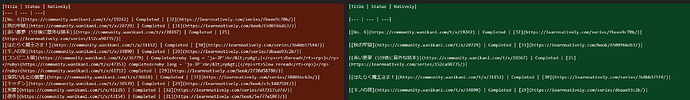

After my investigation, this seems to be caused by arrayToTable using \r\n :thinking:
In my experience on Windows, using just \n fixes this problem. But I’m not sure if it will work on Mac. :face_holding_back_tears:
This should fix this bug:
