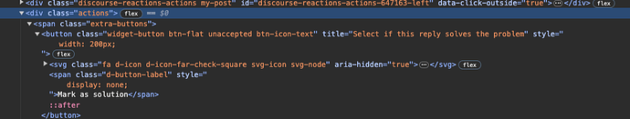

I’m testing out this solution, and I have a question. When one is the original poster, there is an additional button label that is sent to the DOM
Mark as solution which creates duplication with this solution. Do you have any suggestions on how to deal with this? Should I just hide the button label in the CSS?
Thank you!
Hi @tynaut,
I also noticed that there is not an easy way to left-align the buttons so that on hover they don’t jump. The only solution I’ve found is adding a width to the button, which is probably less than ideal given that it’s not a fixed-width element. Do you have any other suggestions for this by any chance?
It is best to combine both measures, because the button will jump indefinitely if the cursor stays at the end of a non-fixed element when the text changes.
nav.post-controls {
    .actions {
        width: 100%;
        .extra-buttons {
            margin-right: auto; // adjusts button to left
            .widget-button {
                width: 200px; // set to value that covers max text
CleanShot 2023-12-14 at 10.51.55
You could hide the hover background color and use a different approach to indicate hover if wanted.
DOM text can be set to font-size: 0;.
And the pseudo elements (and the .d-icon class) would need their font-sizes specified since they are children that will inherit that property.
