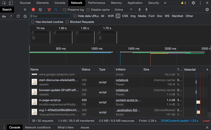

You might be able to narrow this issue down by opening your browser dev console and looking at the network tab (see image below).
Then, reload the page(s) and test, and you will more-than-likely see any HTTP network status messages like 404, 502, 403, (200 is good) etc and the file or external networking call which is the problem.
Make sure you select “All” in the beginning and then you can drill down to XHR, JS, Doc and more as you see the errors and issues.

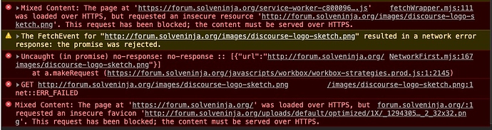

Your site is running on HTTP and not HTTPS and this is causing a lot of JS errors in the browser:
When there are JS errors, like this, the site is not going to work correctly, as you surely know, and this includes any special apps / libs for login, like keycloak.
My suggestion to you is to get your site up and running on HTTPS and try again.
