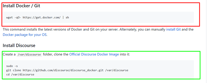

Thanks for kind response, one more issue I am facing with installation:
Following this discourse/docs/INSTALL-cloud.md at main · discourse/discourse · GitHub
When I enter this command ```
wget -qO- https://get.docker.com/ | sh
Character “|” becomes “>” in Digital Ocean console!
Any suggestion how two correctly input “|” there?
Just skip it. Discourse -setup will do it automatically.
You mean I can skip the red outlined part command and directly go to green outlined part?
Aside from what Jay is saying, you really shouldn’t be doing anything significant via the console; SSH into the system instead. That will also make it much easier to, e.g., paste in account credentials from mailgun.
