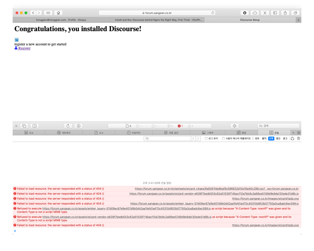

Depuis un navigateur web, j’ai obtenu l’erreur suivante lors de l’installation de Discourse.
[Error] Failed to load resource: the server responded with a status of 404 () (wizard_c4aee3fa9261fde8baf9c596832d10e16a40c298.css, line 0)
[Error] Failed to load resource: the server responded with a status of 404 () (wizard-vendor-e639f7bedb553c62a51539714bacf10a7bb9c2a68ee57d9d9e9da130ede31d8b.js, line 0)
[Error] Failed to load resource: the server responded with a status of 404 () (tada.svg, line 0)
[Error] Failed to load resource: the server responded with a status of 404 () (ember_jquery-57d09ec67e9e407d9b0d42aa1fefd1a470c45310d953b07793a3ca8adc6ec599.js, line 0)
[Error] Refused to execute https://forum.sangean.co.kr/assets/ember_jquery-57d09ec67e9e407d9b0d42aa1fefd1a470c45310d953b07793a3ca8adc6ec599.js as script because “X-Content-Type: nosniff” was given and its Content-Type is not a script MIME type.
[Error] Refused to execute https://forum.sangean.co.kr/assets/wizard-vendor-e639f7bedb553c62a51539714bacf10a7bb9c2a68ee57d9d9e9da130ede31d8b.js as script because “X-Content-Type: nosniff” was given and its Content-Type is not a script MIME type.
