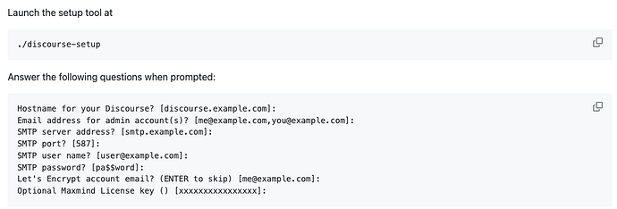

The steps would ask the following; example from the setup guide:
Let the install run it may take a while depending on your internet connection and sever specs. It took around 5-8 minutes to fully complete the install using my VM setup.

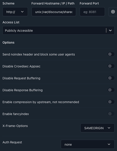

This guide is excellent. I was able to follow the whole thing until I got to loading the web site. I get a “too many redirects” error. When I use the IP, Discourse loads fine, but I can’t get through the redirects issue. So close.
Any help would be appreciated.
Thanks.
