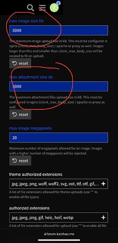

As I was browsing the settings of my Discourse, I saw a note on the “max image size” and “max attachment size” saying that the configuration needs to be adjusted in NGINX and PHP. I was able to do this on my droplet with a LEMP stack for a website, but seeing that I don’t have NGINX and PHP installed on my Discourse droplet, does it mean that the values I put in those categories automatically become the defined limits? Or do I need to install another LEMP stack on this droplet to optimize the setup?

NGINX is already inside the container for a standard install. :+1:

No, there isn’t. It would actually make things a lot more complicated for you.
