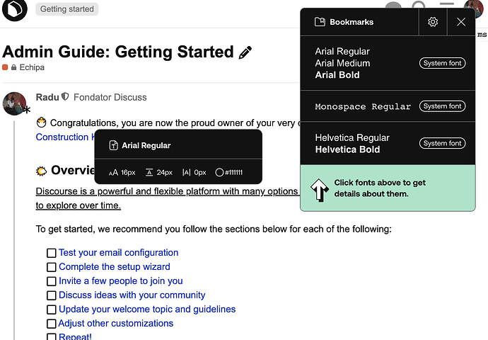

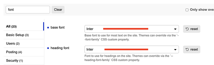

It drives me crazy the fact that I cannot change the font family. I select Inter (or other font family) as my font family and there are no changes, I can’t change the Arial font family.
I also tried Inter with the CSS method with the @import from Google Font. NOT WORKING! How do I actually change the font family?

Obligatory silly question. Did you reload the page?

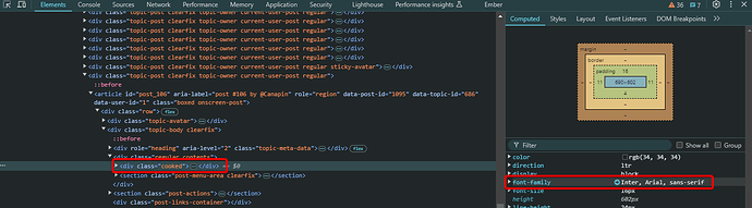

Can you select any text of your forum (like a post contents) and see what font-family is set to, using your browser dev tools ?
Please try clearing the cache or performing a hard refresh of the browser; it will most likely work.
I did all of that. I cannot get rid of Arial.
Thanks @MihirR I did that, I do it all the time. Still Arial everywhere…

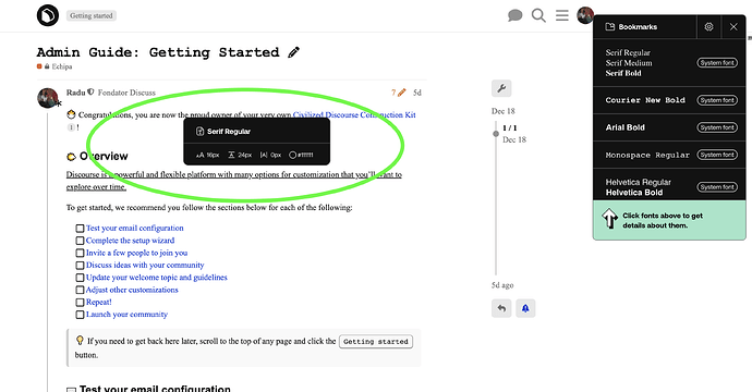

To check why it’s not working, you can add this to your Edit HTML/CSS and see if the new font appears:
body {
  font-family: 'Times New Roman', serif !important;
h1 {
  font-family: 'Courier New', monospace !important;

Is there any error in the js console or network tab?
I tried this yesterday and It works only for H1.

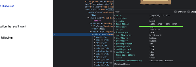

Yeah, it’s for h1. If you want it for everything, you can use this:

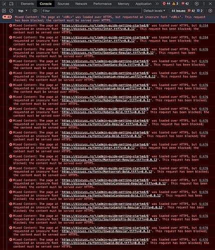

Not working. As you can see above it seems that there are some http problem, I have no idea why since everything else is https.
You may want to diagnose why the font is served over http instead of https.

  font-family: 'Inter', sans-serif !important;
See, if the H1 works, this should definitely work too.

By any chance, are you using a reverse proxy?
Hello :wave:
If so, the force_https site setting is automatically enabled. This is a hidden site setting that you can change in the rails console. It might not be enabled somehow :thinking:
Give it a try :slightly_smiling_face:
