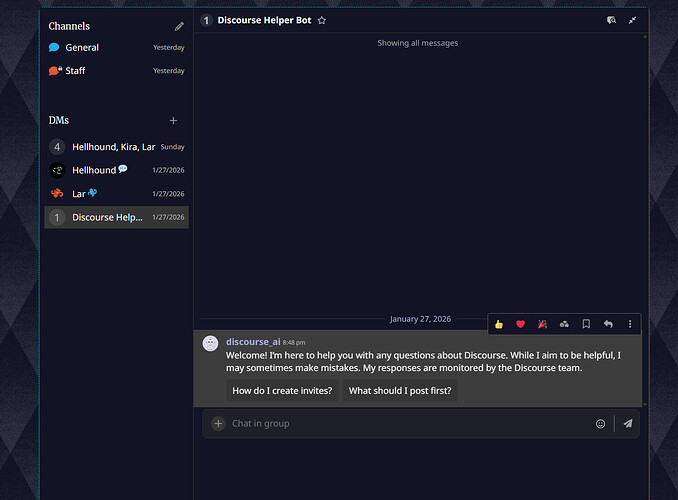

I have recently installed the Sublime theme and am running into a bit of an issue with the full screen chat window appearing to overflow the screen on the height:
I assume this is a CSS issue, and I would like to fix this so the view height of the window doesn’t scroll when the full screen chat is open, but I’m brand new to Discourse and I can’t figure out which class or variable is causing the overflow to begin to fix it. :sweat_smile: Any help would be appreciated!

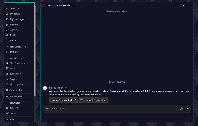

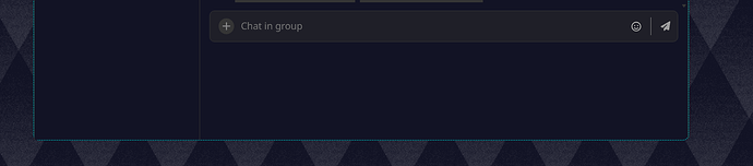

Thank you for the quick fix! Unfortunately it didn’t completely work:
Something I failed to call out the first time is that I’m using the dropdown top sidebar instead of the left aligned sidebar. I don’t know if that makes a difference. But the top of the chat is now completely cut off:

ETA: I played around with it and it is definitely a bug with the header dropdown menu option :sweat_smile:
And it remains broken if you do the header dropdown menu and the separate chat nav:
It does! thanks for looking into it — I’ve added a fix for this case too.

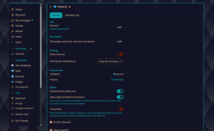

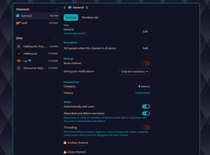

Sorry, back again with a new problem with the full screen chat window that might have been caused by the above fix. I’m honestly not sure, I didn’t access the chat settings panel before the fix was added.
For both sidebar options, sidebar and header dropdown, the bottom of the Settings menu is inaccessible:
Sidebar:
Header dropdown:
