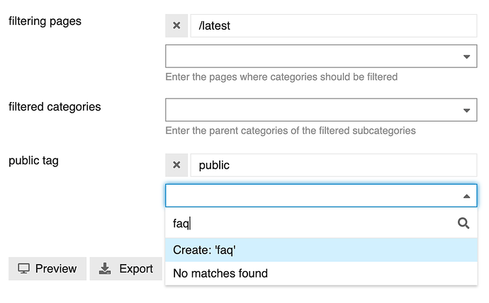

Hi, I’ve installed this theme component and am now having trouble setting it up. When I try to choose tags and filtered categories, mine don’t seem to show up. As an example, we definitely have a faq tag, but no luck, I can’t select it. I also tried just typing the tag in, but that doesn’t work, either.

The setting parameter do not know which tags exist. You need to write the tag name here, click create: 'faq', and so the tag name will be selected. You can select as many tags as necessary, any one of them will be enough to un-hide the post.
Be careful, if your account has admin privilege, then it has full permission for every category, but hiding a category is done by checking if the account can effectively create a new post. Yours can, so your account will be able to see every post everywhere. To test the component, I advise you to create a test account to see the same thing a user would see.
Thank you. I believe I got this to work and am very excited to see how it goes. My appreciations for your work.
