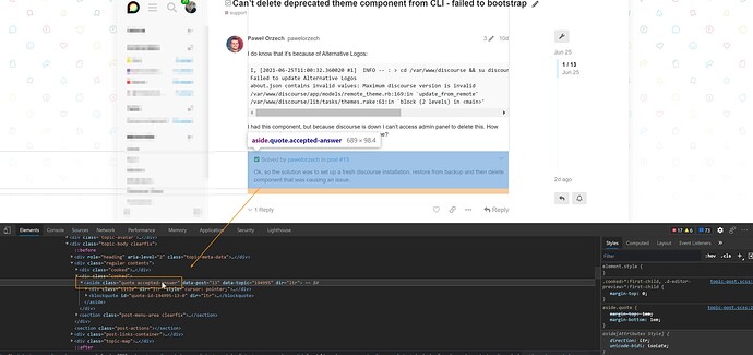

I think at some point .accepted-answer class has been dropped from this div. Is it possible to add it back so that we can style the accepted answer post differently?
In another topic, @awesomerobot said this class has been added to the quote in the first post. But I couldn’t find it for the post body:
That class is definitely visible
Yes, in the quote of the first post it’s there. But I am talking about the post body that contains the answer.
I agree that it would be useful to have a class for the div.topic-body of the solved post.
