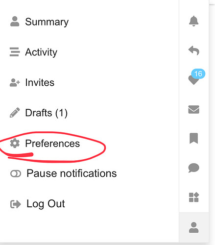

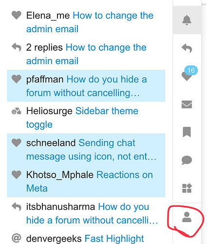

Do you know how to find your own personal user account after login?
Click your avatar and then user icon:
Open preferences:
You are at your account and there you can change your email. AFAIK that is a bit different thing than changing kind of systemwide admin email via discourse-setup, though. Well, I have tendency to be wrong every now and then :squinting_face_with_tongue:

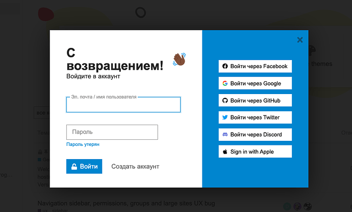

I would like to change email on the welcome page.
And as far as I am an admin this email uses for some technical support. It appears on the Contacts of the forum.
I have attached the picture to show you what email i would like to change.
The first line is an email.
Thank you in advance.
If I remember, then the about page will display the first email in the developer emails setting.
That seems clear.
That’s not a welcome page. It’s the login page.
Are you referring to this field?
There is no email address printed there, just a field where you enter your email address or your username. Other users will enter their email address there, but I expect that most users enter their username and not their email address.
Do you want to change the email address connected to your admin account? The email address where Discourse sends you notifications? Then you do that from your user profile. (But you can also log in on that page without an email address, but only the username and password.)
Do you want to change the social logins on the right?
I don’t think that’s the intention as the screen shot shows the login page. Right?
I might have misunderstood the post, I understood it as “how can I change the email on /about”
