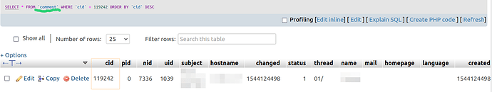

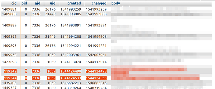

It really doesn’t make any sense. The problem is like this, the two highlighted rows should be the 2nd and 3rd replies in the thread, but in Discourse they’re somewhere after the 500th position because that’s where their timestamp is.
And of course Drupal decided to set the created and changed to the same thing… And it only happens sometimes, I can’t reproduce it myself by editing old posts. But I have this same problem in multiple long-running threads where the OP of the topic posted it and then immediately posted one or two follow-up comments with “reserved” in the body for adding additional information later, which he did several years later.

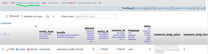

That would make sense, but here’s the same problematic edited comment spread across the two tables it uses:
OK, it looks like this works, it fixes the two jumbled threads I found and doesn’t seem to hurt anything else.
