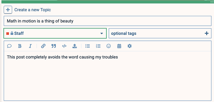

When I try to create a new topic containing the text string “math” in either the title or the topic text, I get a “500 error” pop-up. Doesn’t seem to matter which category. We do have a tag “math,” but the sample post triggering the error is not tagged. If someone creates a post with an alternate spelling like “m ath,” the user is able to go back and edit “m ath” to “math” successfully. The topic create seems to be the point of failure.
Any help would be greatly appreciated.
The error log reports:
NoMethodError (undefined method split’ for nil:NilClass) lib/topic_creator.rb:184:in block in setup_tags' lib/topic_creator.rb:183:in each’ lib/topic_creator.rb:183:in setup_tags' lib/topic_creato

Can you please share your /admin/customize/watched_words/action/tag page configuration? I assume you have an automatic tag “math” stuff in there?
4 לייקים
Thanks! That was the problem. One of the moderators created an automatic tag based on “math,” but didn’t actually assign the tag. I removed the offending watched word and everything works as it should. I really appreciate the pointer.
2 לייקים
Thanks for the reproduction steps @PapaBear. I have a fix so we shouldn’t allow this to happen anymore:
https://github.com/discourse/discourse/pull/17254
