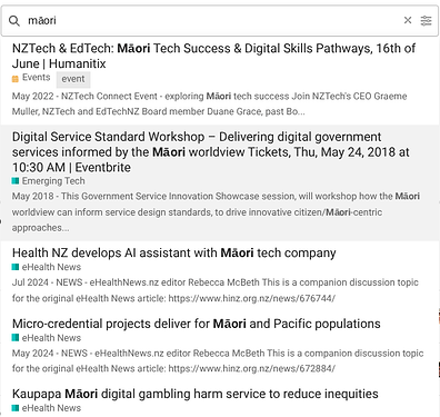

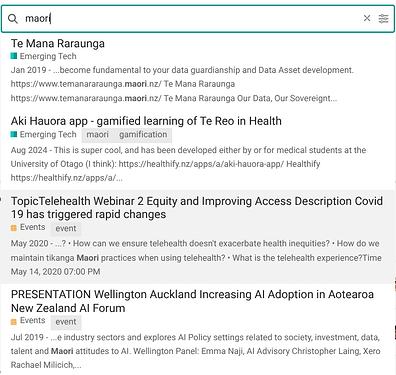

I’m also in Aotearoa NZ; I hadn’t encountered this problem yet, but I can certainly reproduce it on our site:
Using ‘maori’ (without macron)
Using ‘māori’ (with macron)
