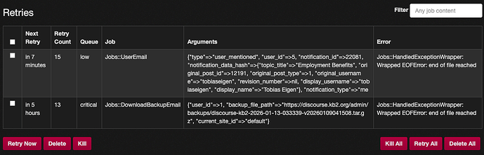

I am updated to latest and am still having an email sending problem on one of my sites. I just get an error message when sending a test email.
ERROR - end of file reached
On mobile now we’ll check sidekiq and logs when I am at my computer. Any other suggestions where to look?
Backtrace
Message (5 copies reported)
Job exception: end of file reached

Just tried the email sending test again on my laptop and get this:
There was a problem sending the test email. Please double-check your mail settings, verify that your host is not blocking mail connections, and try again.
And in the javascript console:
Maybe my problem is different - I will check with mailgun.
Edit: I did see two errors in the retries and deleted them. Still getting the same error now when testing, unfortunately. I also checked the smtp server and that appears to be working.

openssl s_client -connect smtp.mailgun.org:2525 -starttls smtp
(or the same test with swaks).
Mailgun supports 2525 specifically for environments where 587 is interfered with by firewalls, egress filtering, or provider-level network rules.
If:
  • 2525 works and 587 doesn’t → very likely network / IP / routing interference
  • both fail → even stronger case that something external is blocking or terminating the connection
Either way, the behaviour matches “external connection interference” much more closely than a Discourse or Sidekiq regression.
I haven’t heard back from mailgun yet.. my plan if they can’t help is to just start over with a new hetzner server.
I did try the swaks with other ports, and interestingly I got the same error with 2525, and immediately without any delay.
=== Trying smtp.mailgun.org:2525...
=== Connected to smtp.mailgun.org.
*** Remote host closed connection unexpectedly.
But got a different error with 25 and 465, and it took some seconds for the response to come.
=== Trying smtp.mailgun.org:25...
*** Error connecting to smtp.mailgun.org:25:
*** Connection timed out
=== Trying smtp.mailgun.org:465...
*** Error connecting to smtp.mailgun.org:465:
Not sure what to make of that. Maybe there is a misconfigured firewall on the server blocking some ports.
that is intentional and expected.
Hetzner blocks those ports by default.
Makes sense.. but it’s interesting that 25 and 465 took longer to fail than the other ports. Anyway, this is not urgent and I will wait to hear back from Mailgun. This is for my family site so I am just encouraging everyone to log in and check for notifications for a change, and not just wait for email!
Heading to Germany for a visit to family and a funeral tomorrow.. next week I’ll look at this again and likely just start over with a new server.
Thanks for all the guidance! I learned alot through this process. Really like that swaks tool.
Timing can be useful information indeed.
When a port (more generally, traffic) is blocked, it can be blocked by dropping (silent rejection) or rejected (an “unreachable” message (e.g. port unreachable) is sent back to the originator.
A silent drop causes when you see with 25/465 - a connection attempt is made and nothing happens until the timeout is reached.
A rejection causes a message such as “Connection refused” or “Port unreachable”.
That’s indicative of intended behaviour - you’re getting a connection and then the connection is being immediately closed.
You’ve varied the source, so something else you can try is varying the destination. Try the same command against e.g. smtp.gmail.com or smtp.office365.com. You should get an authentication failure, and that’s a strong indication it’s mailgun rejecting you specifically.
That explanation from @supermathie is spot-on :+1:
The timing difference is actually useful signal, not noise.
To summarise what you’re seeing:
  • 25 / 465 timing out → silent drop (Hetzner policy-level block, expected)
  • 2525 connecting then immediately closing → TCP path is fine, but the remote side is terminating the session
That last one is the key detail.
Because:
  • the TCP handshake succeeds
  • TLS negotiation never really begins
  • and it happens instantly
…it strongly suggests Mailgun is rejecting the connection early, not Discourse, Sidekiq, or Ruby.
This lines up with a few things we’ve seen recently:
  • IP reputation / region-based filtering
  • new Hetzner IP ranges not yet trusted
  • or Mailgun-side policy checks before SMTP banner exchange
Nothing in Discourse would cause immediate remote socket closure like that - Sidekiq just hands the message off to Net::SMTP and waits.
