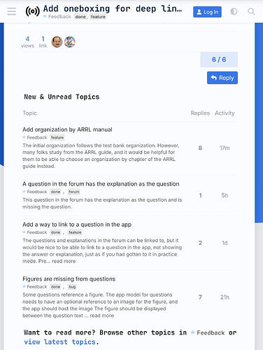

I think that may be a misunderstanding. As I understand it, the setting is for the suggested topics that are displayed under a topic. It’s not for “your topic is similar to”.
The suggested topics below this feedback topic are all from the feedback category.
But I agree this was easier to understand when, instead of “New & Unread Topics”, “Suggested topics” was shown above that list. This was changed in UX: Topic recommendations tweaks. (#22880) · discourse/discourse@e7fb4be · GitHub. But the setting still refers to “suggested”.
4 לייקים
EDIT – Moin beat me to it, but I’ll add my thoughts anyway:
I think that setting affects what’s listed below a published topic…
…either in New & Unread (as on my own non-AI-enabled site):
…or in the “Suggested” section (as here on Meta – presumably because of the additional AI “related” tab)…
I figure the behavior you see in the Composer is intentional. IMHO it makes sense to warn of similar topics sitewide. There could easily be duplicates across, say, #bugs and #UX.
