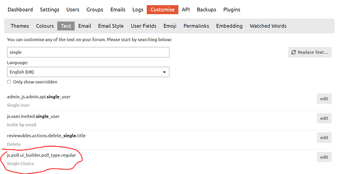

For the naming of Single versus Multiple you can modify this manually. I think this is the text:
