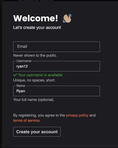

Hi all! I was able to get SSO for Discourse via my Memberstack login to work! Once I login via OpenID to my Discourse forum, I get a pop-up to “create my account” on the forum. Is this what is supposed to happen or should I be logging me in directly? I’ve included a screenshot of the pop-up I get once I login with my Memberstack info. Thanks in advance!
From your screenshot, it doesn’t look like your email address is being filled in on the login form. It’s been a while since I watched the Memberstack video (https://docs.memberstack.com/hc/en-us/articles/8161104982043-Custom-SSO-Integrations), but I think the Discourse openid_connect_authorize_scope site setting needs to be set to openid email profile so that both the email address and username are included in the payload that’s sent to Discourse.
I don’t have things setup to test this right now, but you might need to enable these settings to skip the create account popup (otherwise, the fields should still get filled in, but users will have to click the “Create your account” button):
auth skip create confirm (definitely needs to be enabled to skip the create account popup)
auth overrides email
auth overrides username
auth overrides name
The easiest way to test this out is if you’ve got a non-admin account on your Webflow site. That way, you can try logging in as that user multiple times, and just delete their account on Discourse if it’s not working as expected.
Thank you SO much Simon! Adding in those additional items in “openid_connect_authorize_scope” fixed it and enabling “auth skip create confirm” skips the popup and goes directly to the forum homepage! I enabled " openid connect overrides email" - what does this do?
