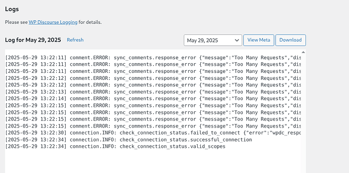

J’ai mis à jour WP-discourse vers la dernière version aujourd’hui et pour la première fois, j’ai commencé à voir ces erreurs :
[2025-05-29 13:22:11] comment.ERROR: sync_comments.response_error {"message":"Too Many Requests","discourse_topic_id":"3886","wp_post_id":3151,"http_code":429}
[2025-05-29 13:22:11] comment.ERROR: sync_comments.response_error {"message":"Too Many Requests","discourse_topic_id":"3888","wp_post_id":3026,"http_code":429}
[2025-05-29 13:22:11] comment.ERROR: sync_comments.response_error {"message":"Too Many Requests","discourse_topic_id":"3889","wp_post_id":2374,"http_code":429}
[2025-05-29 13:22:12] comment.ERROR: sync_comments.response_error {"message":"Too Many Requests","discourse_topic_id":"3890","wp_post_id":2288,"http_code":429}
[2025-05-29 13:22:12] comment.ERROR: sync_comments.response_error {"message":"Too Many Requests","discourse_topic_id":"3891","wp_post_id":2083,"http_code":429}
[2025-05-29 13:22:13] comment.ERROR: sync_comments.response_error {"message":"Too Many Requests","discourse_topic_id":"3892","wp_post_id":2031,"http_code":429}
[2025-05-29 13:22:14] comment.ERROR: sync_comments.response_error {"message":"Too Many Requests","discourse_topic_id":"3894","wp_post_id":1495,"http_code":429}
[2025-05-29 13:22:15] comment.ERROR: sync_comments.response_error {"message":"Too Many Requests","discourse_topic_id":"3895","wp_post_id":975,"http_code":429}
[2025-05-29 13:22:15] comment.ERROR: sync_comments.response_error {"message":"Too Many Requests","discourse_topic_id":"3896","wp_post_id":841,"http_code":429}
[2025-05-29 13:22:15] comment.ERROR: sync_comments.response_error {"message":"Too Many Requests","discourse_topic_id":"3897","wp_post_id":783,"http_code":429}
[2025-05-29 13:22:15] comment.ERROR: sync_comments.response_error {"message":"Too Many Requests","discourse_topic_id":"4023","wp_post_id":730,"http_code":429}
Des idées sur la cause ?

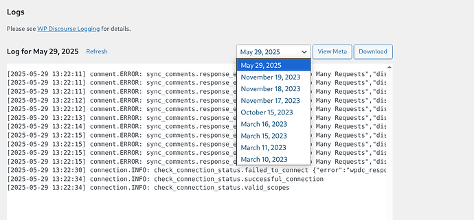

Avec la version 2.5.7, la capture d’écran ci-dessous montrerait déconnecté à moins que je ne clique sur enregistrer à chaque fois sur cette page. Même dans ce cas, si je cliquais sur un autre onglet et revenais à la page principale du plugin, il indiquerait déconnecté à nouveau. Depuis que je suis revenu à la version 2.5.6, il indique TOUJOURS « Vous êtes connecté à Discourse ! » que je quitte cette page/onglet ou non.
J’ai trouvé cela étrange, mais j’ai pensé que c’était peut-être comme ça auparavant et que je ne l’avais pas remarqué, donc je n’ai pas la capture d’écran d’avant car je l’avais simplement ignorée. Après être revenu à la version 2.5.6, j’ai réalisé que ce n’était effectivement pas normal et que cela ne s’était produit qu’après la mise à niveau vers la version 2.5.7.

Cela ne devrait pas causer ce comportement.
J’ai re-testé la version 2.5.7 sur plusieurs instances et je ne parviens pas à reproduire ce comportement. De plus, j’ai du mal à voir comment les modifications apportées à cette version pourraient causer quelque chose comme ça.
Nous venons de publier la version 2.5.8. Pourriez-vous mettre à jour uniquement le plugin, rien d’autre, et voir si le problème se reproduit ?
1 « J'aime »
Ok, je ferai ça ce week-end.
1 « J'aime »
J’ai tout mis à niveau hier et aucun problème jusqu’à présent.
1 « J'aime »
