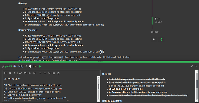

I’m not sure whether this bug is specific to Discourse but when I try to strikethrough several lines of text & one of those lines is a quote, the quote’s text is not struck out.
The preview displays the quoted text as struck out -
but when posted, it renders like this -
Striking out each line instead like this -
does behave as I was expecting -
