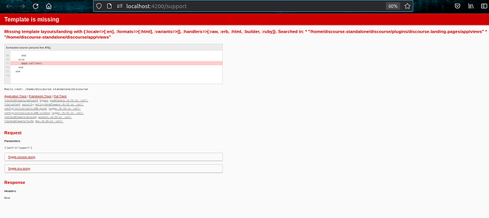

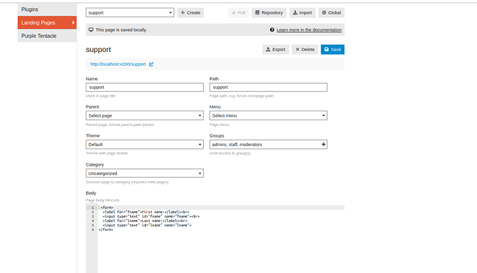

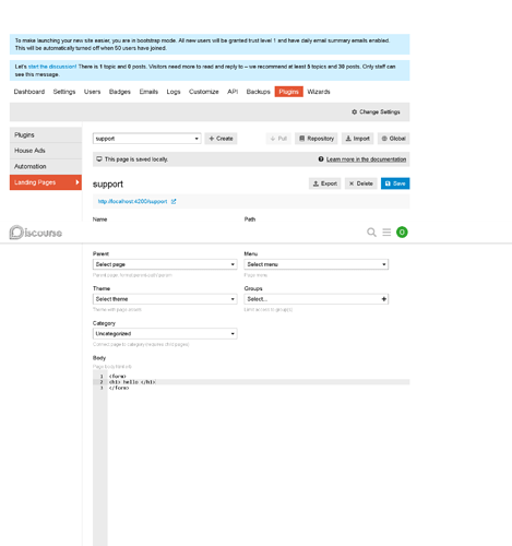

Thanks for feedback @4ong .
I have tried this plugin but getting challenges with it. Please have a look at the screenshots.

Hi @Rajeev
I’ve tested on localhost and the plugin works correctly
So can you describe more about the problem that you have - maybe we will find a solution together.
@4ong I appreciate that you are concerning about my issue. I want to know how you setup your local host. Are you running it as docker image or standalone application by ruby server ?. Because I am running it as standalone by ember and ruby server.
