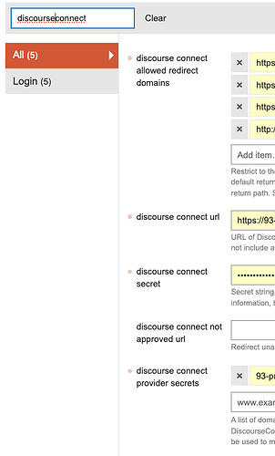

Some of the names and UI have changed slightly since the post went up, but by and large everything is fine. Except the key configuration - enable discourse connect aka enable_discourse_connect - is not available at all.
So, after configuring everything else and attempting SSO from my IDP application, I get to the session/sso page and receive a 404 ‘Oops’ message.
Is this setting hidden in trial mode? Is there some kind of restriction on this setting?

Can you confirm that your sandbox site is not on Discourse’s Basic plan? Are you seeing other Discourse Connect related settings?
copying my reply here so that this thread will persist for anyone who runs into this in the future
yes it’s the hosted cloud version, on a sandbox, which I assume means basic.
Haven’t done much other work on the site, so sounds like it will be easier to create a new sandbox on a higher level plan.
And, yes, lots of other SSO and Discourse Settings do show up. I was able to get everything configured except this one setting.

Created a new hosted site on Standard plan, and the “Enable Discourse Setting” is there, and I’m good to go.
