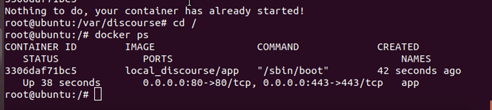

After you do so, what’s the output of: docker ps ?
Web server is not running on the host

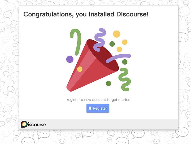

Thank you for your reply. After I rechecked the app.yml file, I rebuilt it and allowed to access port 80. I can open the registration page:
The administrator account is created by rake admin:cearte, but there is no prompt when visiting the web page again, just a blank. How to change the next step has not been found a solution!
Once you have an admin account you can log in and run the wizard by going to https://SITE/wizard.
