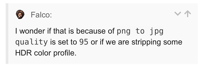

Colors are definitely different. I wonder if that is because of png to jpg quality is set to 95 or if we are stripping some HDR color profile.

I spoke too soon. Some of my uploaded photos on my sites hosted Discourse are still dull. :smirk: Is there something to be done about this “png to jpg quality is set to 95 or if we are stripping some HDR color profile.”?
Having the same problem again. The photos in my photo album are bright and crisp but when I upload them to Food Talk Central and Hungry Onion (both hosted by Discourse) they are dull. Can anyone help me this time? This screenshot is from @falco on this thread 3 years ago. Could this be the same problem?

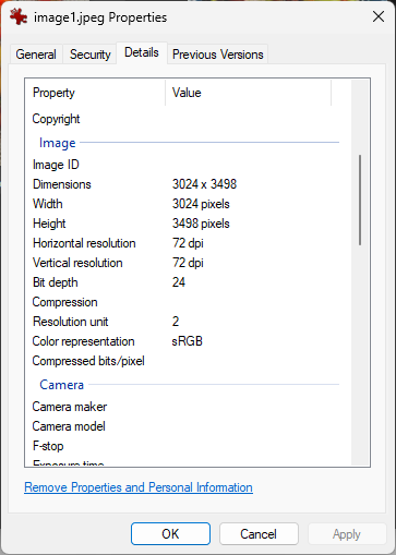

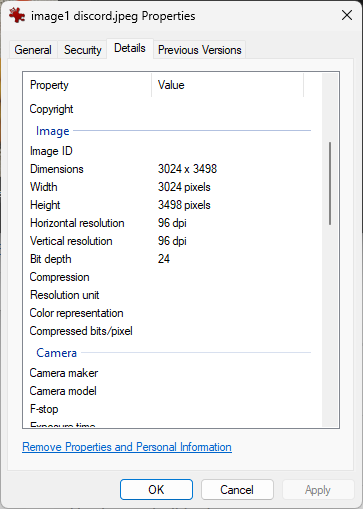

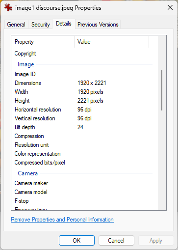

If I download both the Discourse and Discord pictures (that appear both redder in the browser) on my hard drive and open them both with Irfanview, only the picture downloaded from Discourse appears redder. The picture downloaded from Discord looks like the original BUT appears redder in the browser. :face_with_spiral_eyes:
In conclusion… I have absolutely no idea about what’s going on :grimacing:
(the original photo isn’t HDR by the way.
Original:
Recompressed by Discourse:
Uploaded on Discord: (I don’t know what Discord does with the uploads, but the final image is slightly lighter than the original)
