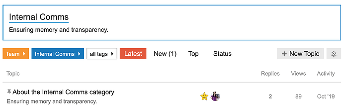

Here’s an example of a user who has muted “Internal Comms”

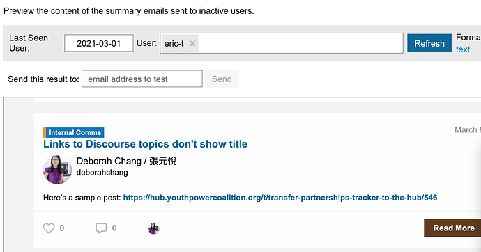

When I previewed their summary email, Internal Comms showed up.

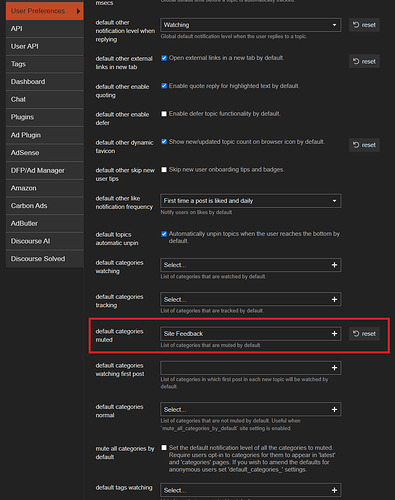

I’m seeing topics from a Muted Category going in in the Summary digest emails (under Popular Topics). Is there some specific settings that needs to set to prevent this from happening?
For example, the Site Feedback category is muted but I’m still seeing topics from that category being sent out in the digest emails.

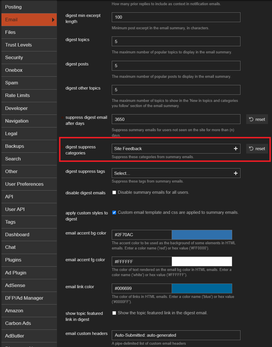

There’s also the digest suppress categories admin setting, which sounds like it could be useful here:
That’s also enabled, it’s still sending topics from that category.
Hmm. I’m afraid I can’t repro this on my test site. If I add a category to digest_suppress_categories it doesn’t show in my activity summary, and if I remove it it then shows up.
