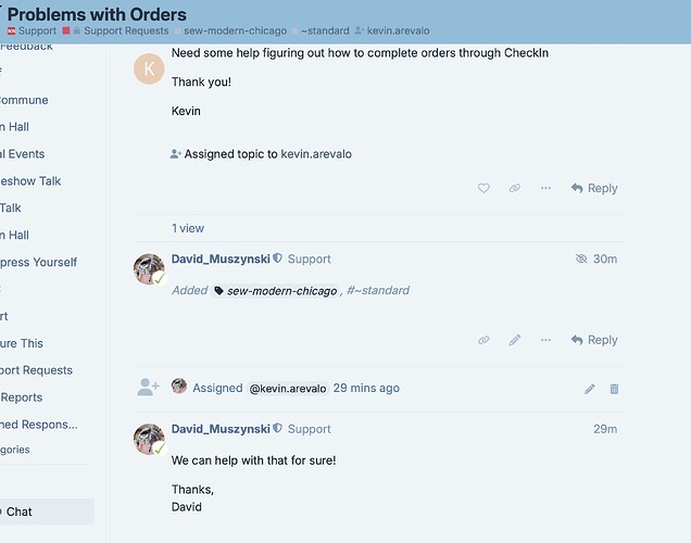

If you look at this screenshot, you can see that I just created a new topic and there is a post under it:

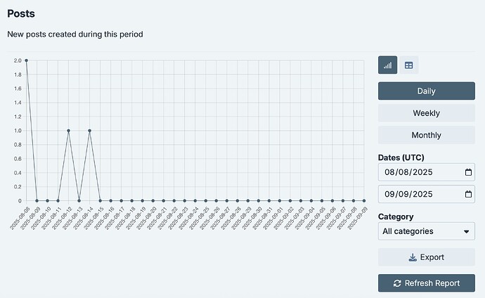

And if you look at the report for posts, it says there haven’t been any since Aug 14th, that’s not right. There have been plenty, including the one I just made 40 minutes ago to test with.

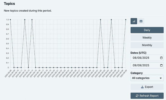

Yes, I use the private topics plugin. Would that stop the system from seeing posts? It still reports on new topics correctly:
The system can still see them. But the plugin changes the code that defines what counts as a public post.
The report counts public posts
And the plugin changes that definition
If private topics is enabled and the post is in a category where the plugin is enabled, it’s excluded, so it’s not counted
