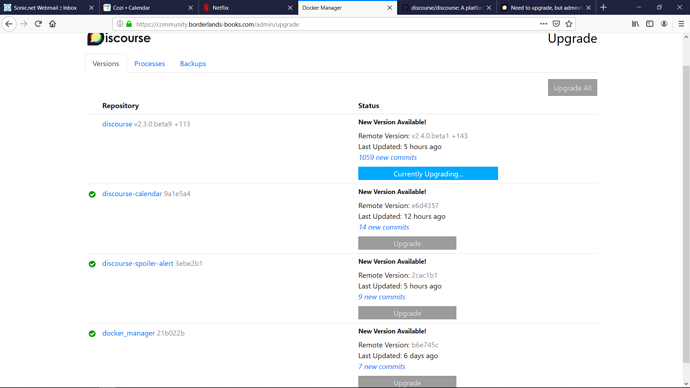

I have been struggling with updating.
I have successfully done it manually, but it was nerve wracking for me. I am more a wysiwyg kinda user.
I am pretty sure that I successfully updated from the admin/upgrade page
But now it is locked up again.
Is it likely that this ProCourse solution will facilitate upgrading in the future?
Jay did my install so I can say with confidence it wasn’t a glitchy install : -)
This is what I am seeing;

It might be that if you scroll down and upgrade docker_manager first, then upgrade all button will light up.
But, if you haven’t done a command-line rebuild in the year since your install, then you probably need to. See Redirecting…
(Oh, maybe I upgraded you in March and you should be OK.)

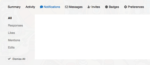

@pfaffman @Falco Uninstalled ProCourse, as well as all other unofficial and official plugins. After rebuilding the app, still same thing. Notifications won’t login and Notifications tab appears empty for some users even if they keep receiving them.
empty
I really don’t know what else we can do. It was clearly not coming from the plugins, but we had to try. What else could we do?
Yes. You had to try. Removing plugins is always the first step with almost any problem.
Next guess would be themes. Then ram and disk space, which also seem unlikely. Do you have swap?
